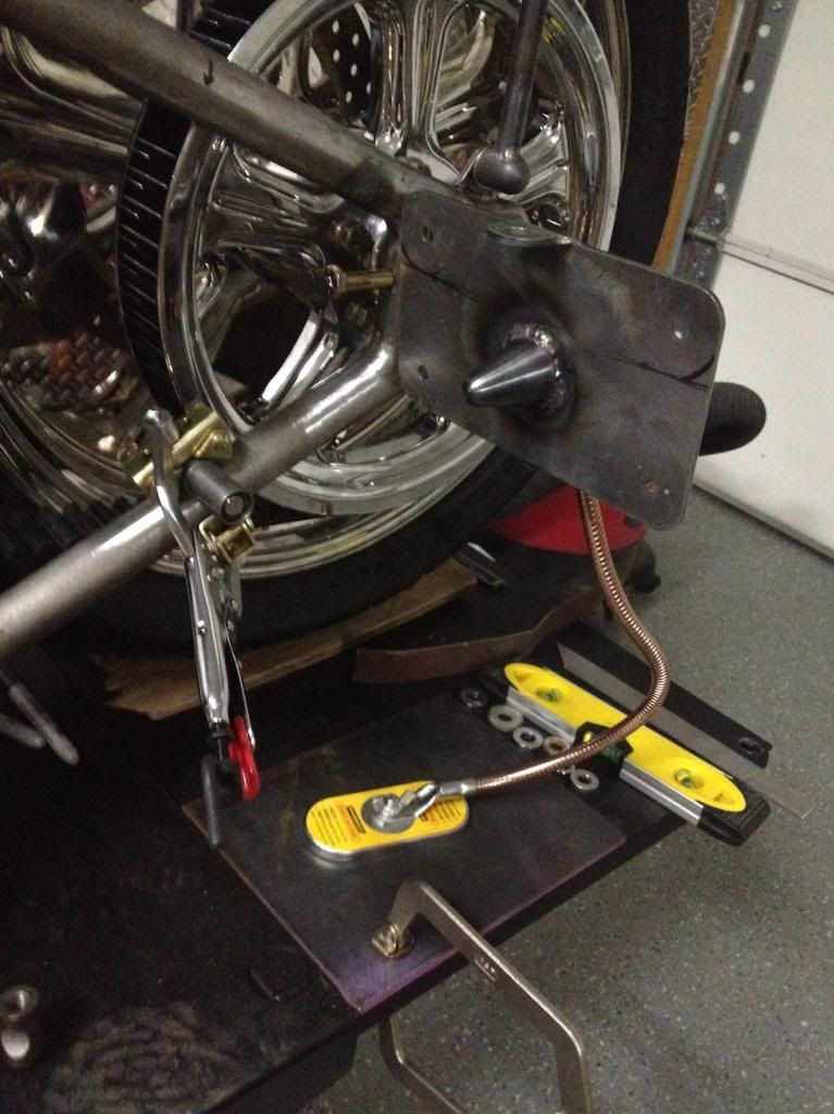

It was a hell of a busy weekend for me. I was hoping to be done with fabrication but I came up a little short. Still just a couple things left to do so they'll have to wait till next weekend. No big thing, I was pretty happy with what I got accomplished since Friday night.
Starting to set up the stop light/tag mount; The tag bracket came from Bung King. I had a few of the 'bullets' turned at a local machine shop from 1.25" round bar. Then two counter bore 3/8" bungs and two 3/8" bullet bungs also from Bung King.
  #164 (permalink)
Old 03-04-2013, 07:43 PM
CloudDiver's Avatar
Join Date: Apr 2012
Posts: 1,103

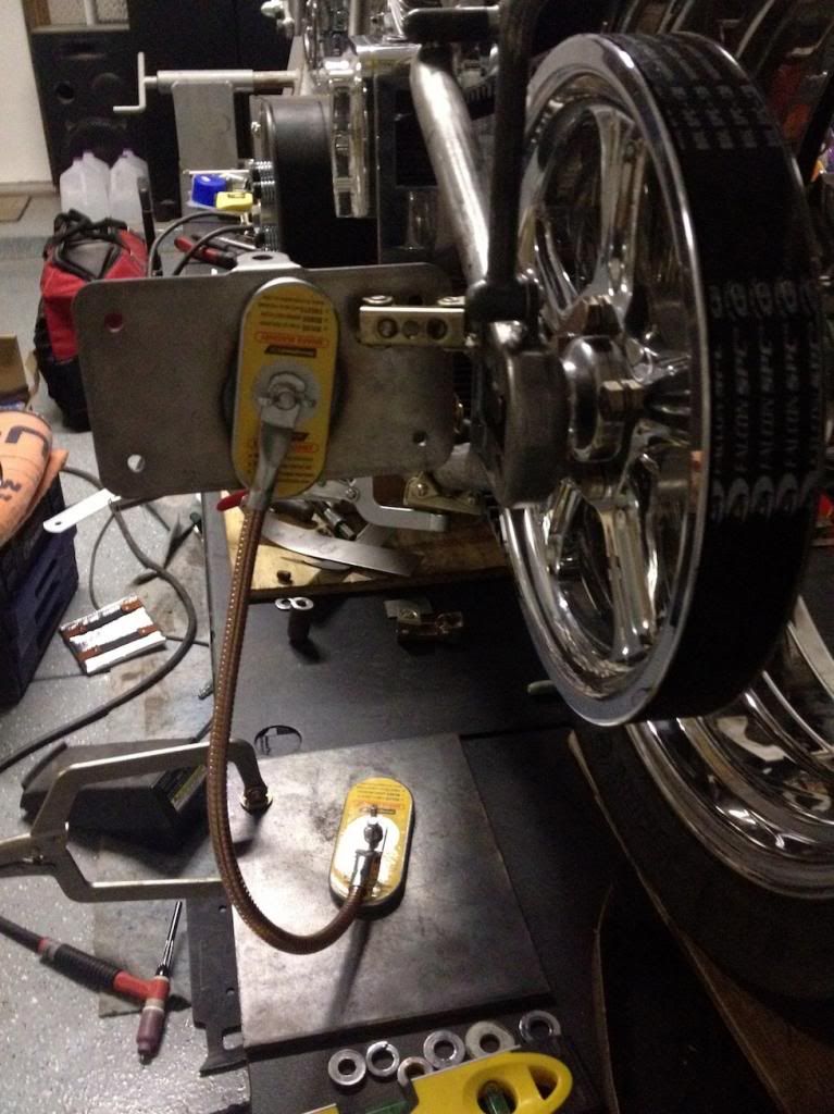

I made sure the frame was level again and used these magnet clamps from Strong Hand Tools to keep everything in place.

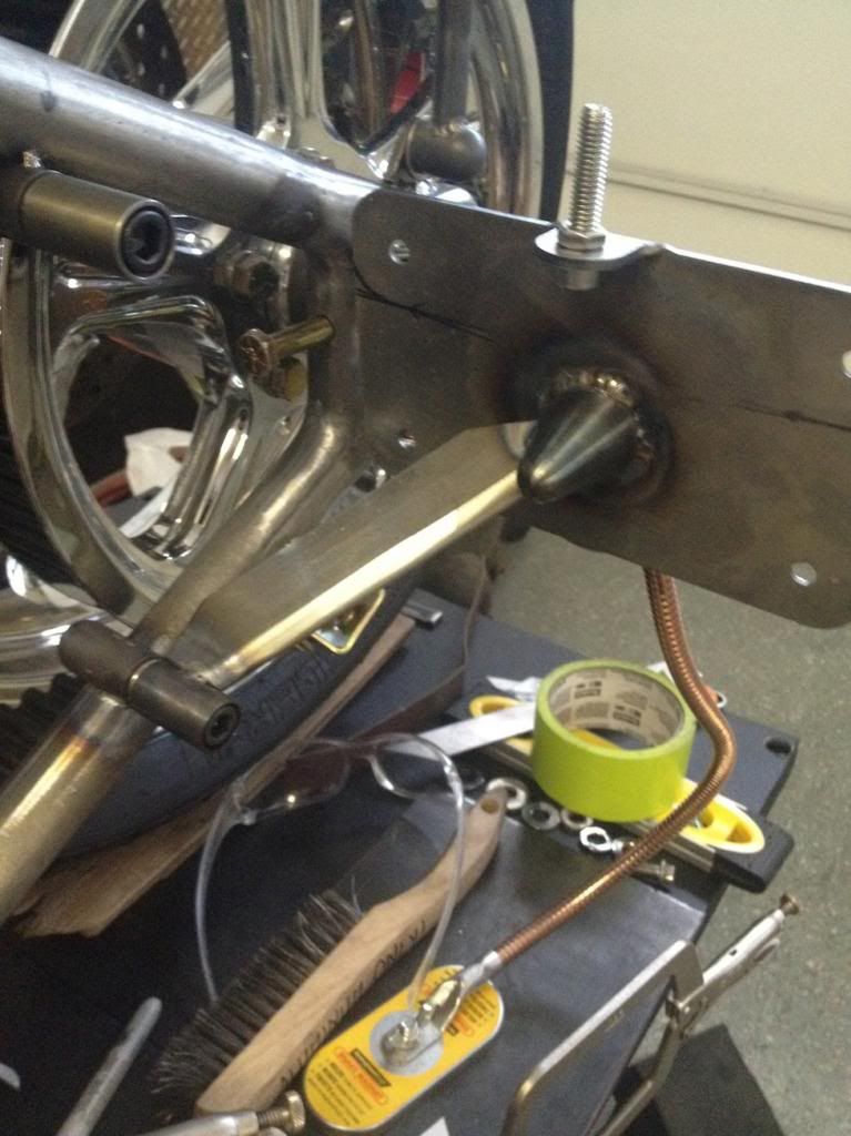

I used illustration board to make templates of the arms. Easier to figure out the angles and copes before cutting the steel. I didn't take enough pictures showing the paper board arms in place, but trust me, this took a long time to get right. After cutting the steel it was even longer trimming the arm just right with the flap disc and files...
