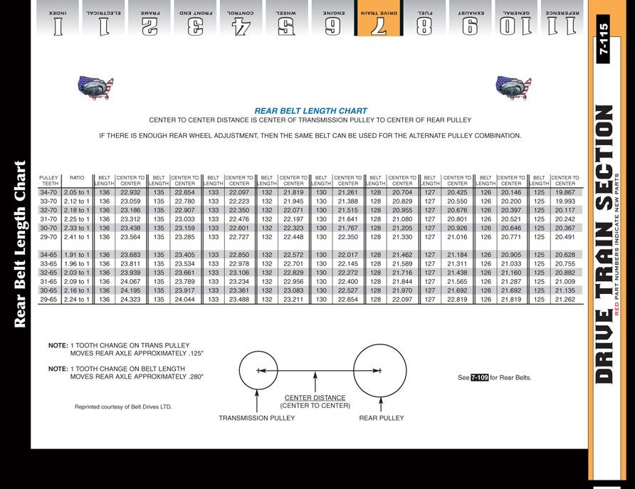

I know this chart does not even go close to 140 tooth belts, but if you look at the change in distance in 2 tooth increments you may be able to figure exaclty what tooth count you will need.
I mentioned in my Ugly Betch build thread I had to change rear belts. I still can't figure out why my 127 tooth belt would not fit back on when I have the same size but new pulleys installed? I had to go to 130 tooth. Using a measurement of the center of trans shaft to the rear axle center I used this chart to figure I needed the 130 tooth. I didn't seem like only a 3 tooth count difference would make up much, ut only a couple teeth can seem like a mile on rear axle position. I hope this helps!

Cloud, I spent a lot of time trying to find a belt in the 141-146 range and came up dry. All the experts told me there was nothing available just a 140T touring or 149T vrod belt. I even called gates and they told me the same thing. Then you chime in and bingo I found myself a 2010 buell 1125 belt that's perfect a 145T. The only one available at HD in California was close enough to go pick up. The 140T was so short we couldn't even slip the axle on. According to the chart above the 145T is going to buy me 1.4" which might not even require the fender to be pushed back. Thanks buddy I owe you one!

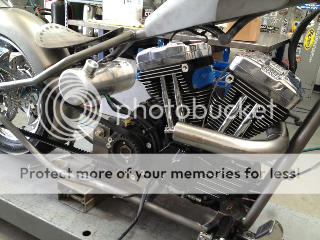

Thanks to Cloud we were able to make the 145T buell belt fit. Had to swap the 27T transmission sprocket with a 28T but I'm happy I can use my matching doom 61T rear pulley. The stock setup for a 2010 sportster 1200 is 68/29 so going 61/28 is kinda geared to cruising but it should be good because sportsters are set up for acceleration and guys tend to put larger transmission pulleys on sportsters for better cruising and not the only way around.
The exhaust is in the works. Gonna be similar to the SS pipes high and tight 2-1/4 pipe with custom tips.

The rear fender will need to be pushed back slightly now because of the axle position with the belt tightened. So a small step back but some big steps forward. The tail light is from a street bob suits the bike I think. Going to run a sissy bar up and around the tail light. I really wanted to run Twowhlsirvir web struts but they just wouldn't fit. The web struts would have looked awesome but the fender on a 140 (150 in this case) leaves more room between frame rails unlike the 200 cfl. Would have needed dramatic bends and would have been too short. Thanks anyway Devon.

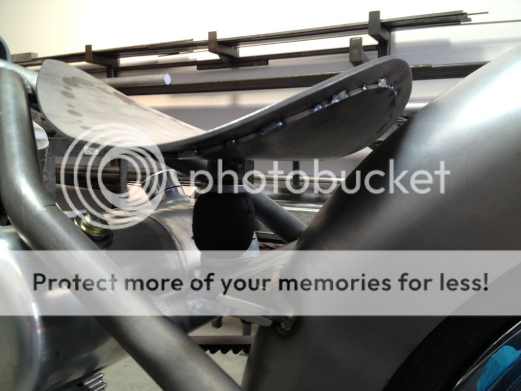

The seat turned out pretty good. Sits fairly tight and almost looks rigid mounted with the hinge being under the pan. It's a Firestone bag about half the size of the Goodyear bags. Use a bicycle pump on the bag with a schrader valve. I think it's gonna be really comfortable. The pan is custom made for my ass LOL.

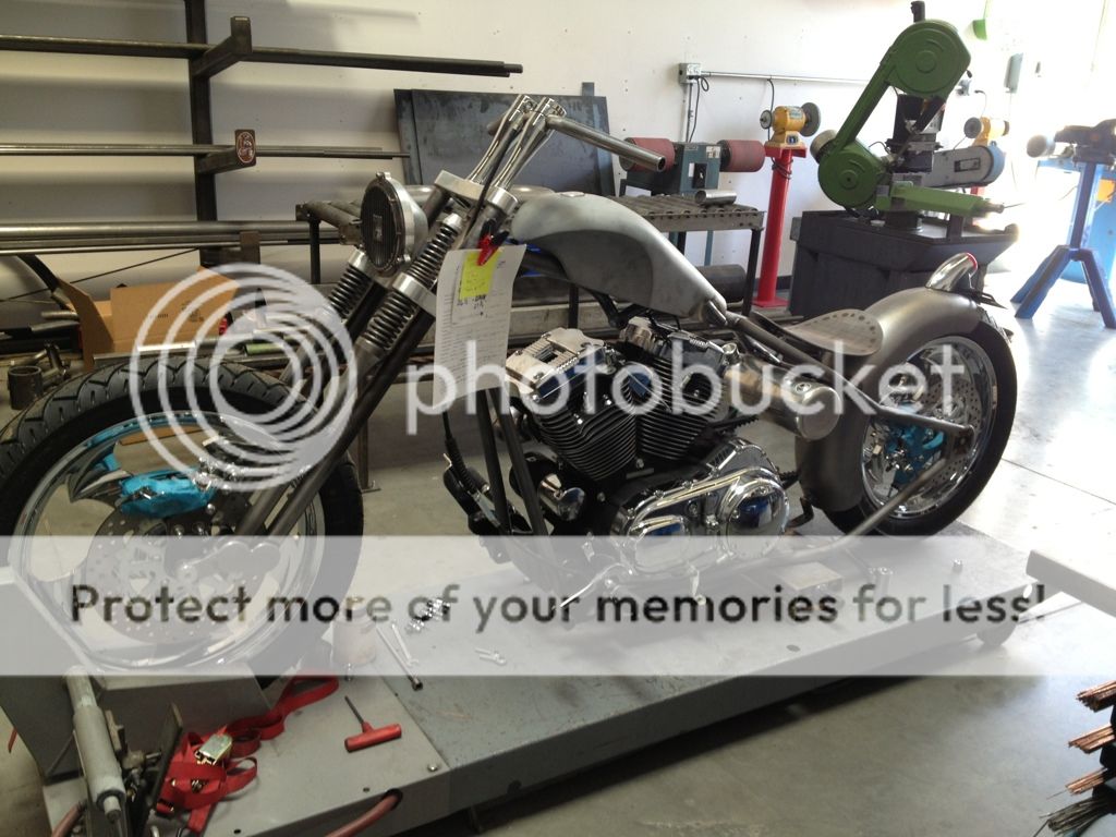

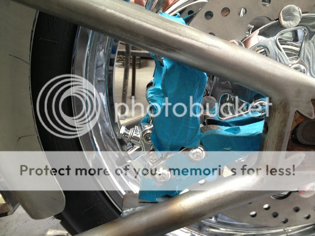

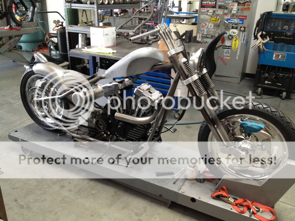

A few more shots of the brake setup. They made a beefy front bracket. The rear bracket was found by John at scooters. Being a RSD the bracket was rare. Running brembo rotors and calipers.
One last shot and that's all until its complete. Just shift link, sissy bar, rear fender adjustment, and exhaust. Then I get to wire and plumb it.
