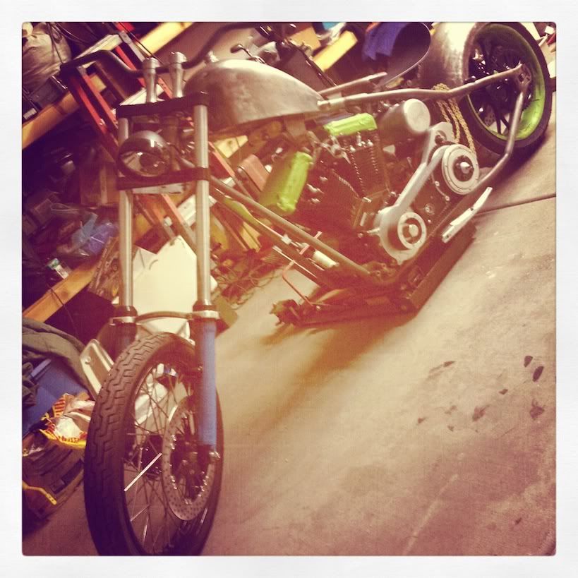

For shits and giggles, here's a pic I took with Instagram...
