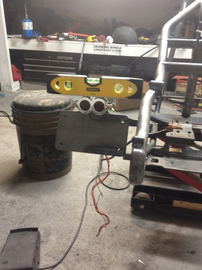

Posts: 1,103
When I read that vertical plate mounts became illegal in California as of 1 January 2011 I decided to go with this one from Fab Kevin with the double-shot tail-light. Got it dead level but to keep the tabs center line on the frame tubes it needed to be shimmed on the bottom mount, just one 5/16th washer.
Interesting about this is that it replaced one of my secret weapon parts... I was going to use a plate mount/light from a Ducati Diavel. If you've seen it you know how it wraps around the tire and floats over the tire with a mudguard. My roommate hated it and wouldn't shut up about it, but that's not why I changed my mind. It would have mounted to the rear brake caliper mount so that it would slide with the axle and always maintain its spacing. I never really figured that part out and I didn't feel like ruining my PM brake mount in the process. The real kicker and the biggest reason I went with the Fab Kevin mount instead was that I hated that the mud guard would cover up a huge portion of my mean-as-fuck rear tire...

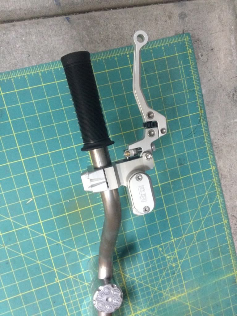

Another secret weapon part... My ISR Hand Controls.
