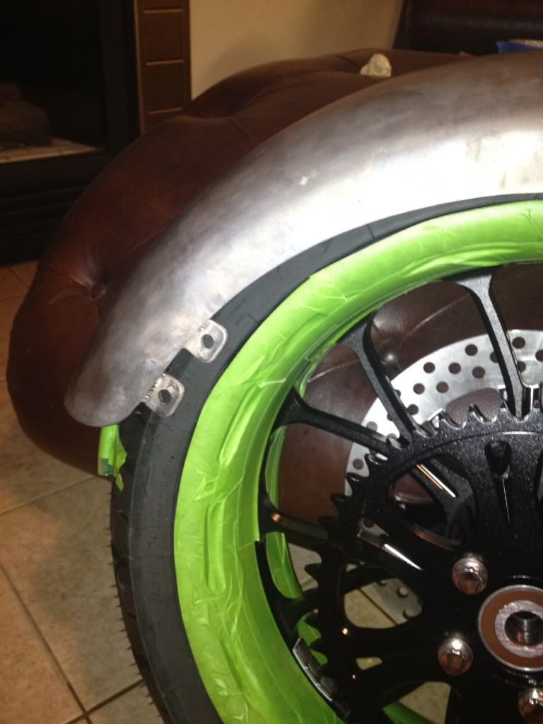

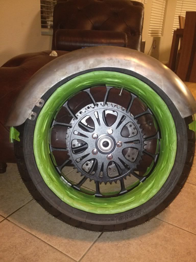

Radius on rear fender, shrink or slice?
I've looked through a few threads and found some info on getting the radius of the rear fender to fit right. Good stuff in the forums but not too many pictures or step-by-step. Poop has a really good photo of a rear fender he made with the slices in the sides and then shaped to the tire.
I'd go the shrinker route but not sure if I need to invest the money in the tool to do just one fender. I think I might try the slicing method.
If anyone has some tips or advice on what works better let me know. The way I see it now is that I have a Lincoln MIG and a plenty of cutting wheels. Slicing and then putting on a ratchet strap and tacking away, then making a pattern on paper against the wheel radius to tidy up the sides is really only an investment in time and sweat vs buying a shrinker with the right die vs. paying someone else to do it.
I'm adding some pics below; the WCC Two eight fender on the PM wheel, my tire is a Dunlop D 616 190/50 ZR 17. The sidewall to sidewall size of the finder is good, so no need to split and widen.

I have 3/8 tube taped to the tire for spacing. I think the green tape highlights the problem areas on the left and right.

This is what the back looks like when pushing the front in against the tire flush to the tubing.

Same concept here, showing the gap in back with the front pushed flush.

Old 07-08-2012, 04:37 AM
Posts: 1,618
its a lot of work ... i use fenders from twisted chopper , ledd sledd or b'cool they follow the contour of the tire great

most west coast rear fenders were designed to run a 18" rear wheel. your going to have to shrink the radius to fit and thats not that easy.

use caution... that much cutting then rewelding... may cause it to warp.... I would use a tig welder...

I did mine with the slice, strap, and weld method. But I didn't get it exactly right so I went at it with a grinder. And that's where I got into trouble, lol . . .

Yeah heard a lot of good things about the fitment of B'Cool fenders, pricey as they may be. I sold my WCC fenders a long time ago. They were junk.

Step 1: throw wcc fender in trash
Step 2: call Randy at Bcool

Twisted choppers man $199 any width you want!!
