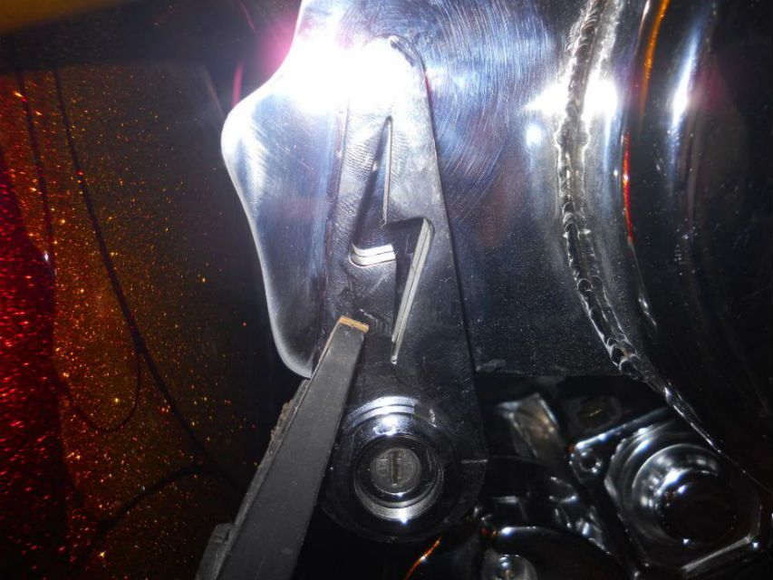

Old 05-07-2012, 07:12 AM
Green Bean's Avatar
Location: Ridgeway, ON
Posts: 100
Old 05-07-2012, 07:17 AM
Posts: 873
That's the same barrel I have, was worried though, does it seriously stay held ito place by the plastic nut?
