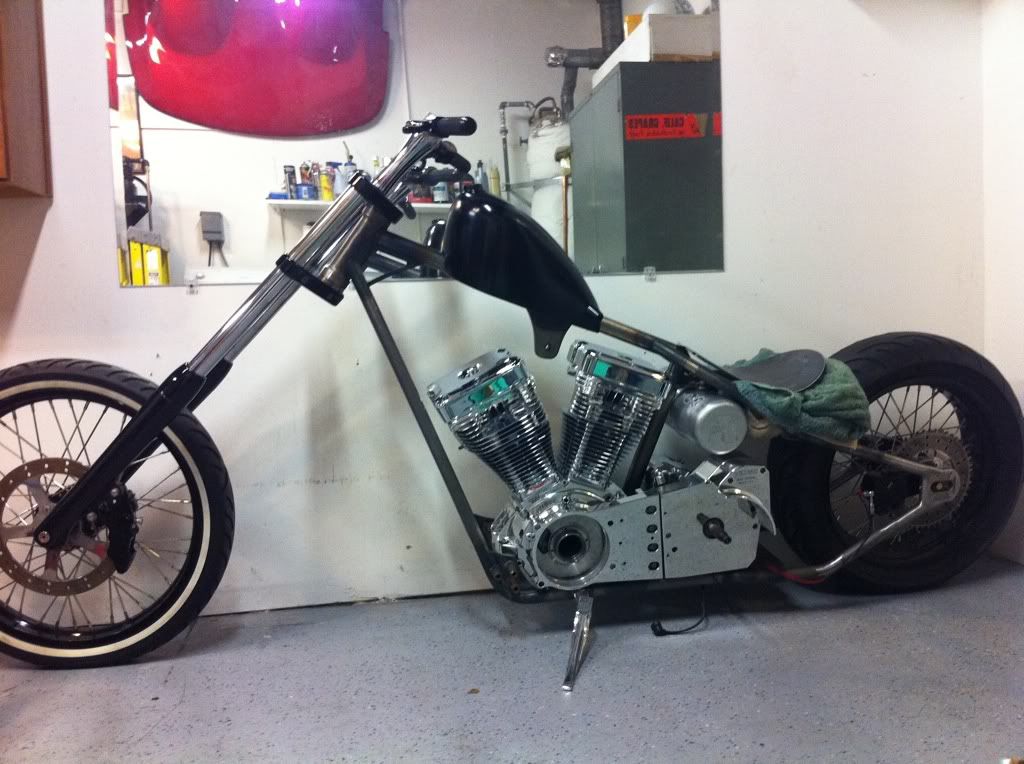

so with the 3 deg wcc tree's what length did you end up going with the forks ?? im about to order the bits and pieces next week for my front end !!
read post 18

i did man and it doesnt tell me anything sorry tat2 , if you had forks that were supposed to 4" over and you cut 4" off them that doesnt tell me how long they are ?? do you know what i mean tat2 !! i thought maybe you had an overall length measurement !! its all good bro sorry to be pain !!!

I know what you mean. Most run 5 degree trees with 6-8 over legs. So if he has 3 degrees trees with stock length legs his lower rails are on the ground. Lol. And from everything Ive found his trail is somewhere around 6 inches with 3 degree trees.
-mr jsp; wcc made 3* and 8* trees
-most gents on here use 5* and 7* on there 4up's w/6" tubes
-and 0* and 3* on there 2up's w/2 over tubes
-ive pmed aprox 20 guys since i got interested

Yep and he stated this is a 4 up frame. I have 7 degree trees right now with 6 over tubes on my 4 up. But changing to 5 maybe 4 degree trees. 4 seems like to much trail.
-id leave the 7* on for a season
-i liked the 0* on my 2up alot...changing to 3* 'ONLY' because its a trade [old stuff]
-if i dont diggitt, swapem back...the trail calc. said 0* was no good...i loved them tho ???
-food for thought i guess

it does get confusing doesnt it ! so if it went 2-3 degree rake in the tree's i could use 5 inch over tubes ?? im a pretty small bloke so i dont want it to stretch out to much i want to be able to ride this thing pretty hard !

-prolly best to start a new thread...depends the frame you have
-0* or 3* on a 4up would look like paul sr.s old school bikes [hi + smashed in] lol lol

My 7 trees are WG and I don't agree think it's to wide for a 200mm bike going with midglide

Well I believe with a 9" rear fender your tank should be close to that not 12" like a stock villian. I plan on narrowing a villian to 9-10" wide. The mid glide trees. To have a perfectly balanced looking bike! Trees are spoken for as of right now if not I'll let you know Cole.

I didn't take an over all measurement after I cut and put a new thread in the end of my tubes. When I take it apart after mock up i can get you an exact measurement. There is approx. 18 3/4" long sticking out of the fork slider.
My trail calculation was just under 6" .
The front end was bought off the chopperdogs site. They came with 8 degree WCC trees that I decided not to use because I did not like the long front end. I then bought the 3 degree trees that were also used off of the chopperdogs site and altered the tubes to the length I needed.
