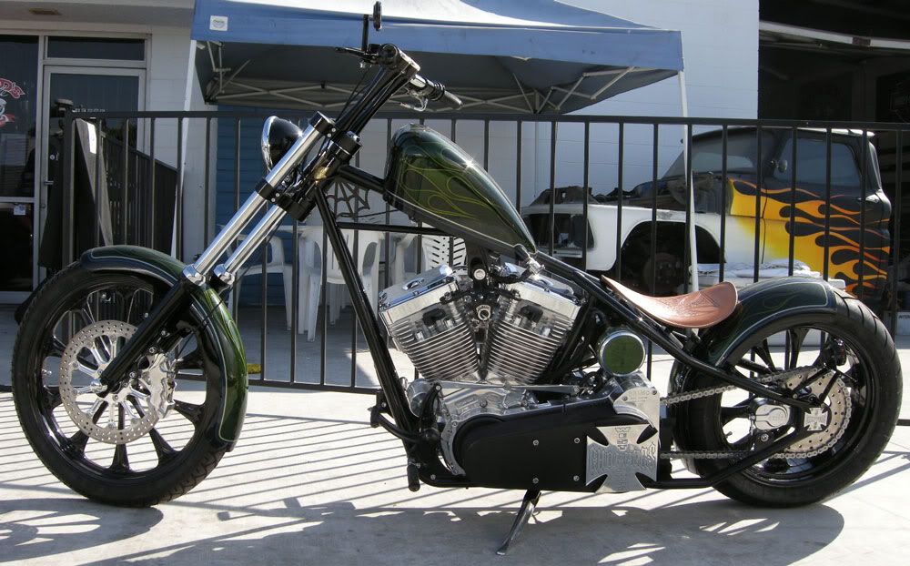

O.G.,...........meaning "original".
It's the older style CFL oil tank that has the battery box welded to it, like the one pictured.
The newer one is by itself and is used with a drop down battery tray on the lower frame rails.

JSP,...........just measured my back bone and it "is" 29 inches from the back of the neck to the center of the seat post so,...........looks like you "do" have a 1-out frame.
And boy,..that tank looks a hell of a lot cooler in primer.
Thanks frank.
yeah it does look alot better but I want the tank on this bike. I think it is a king p-nut. what do you guys think???

Looks good JSP, be nice to see how it turns out. Good Score.
