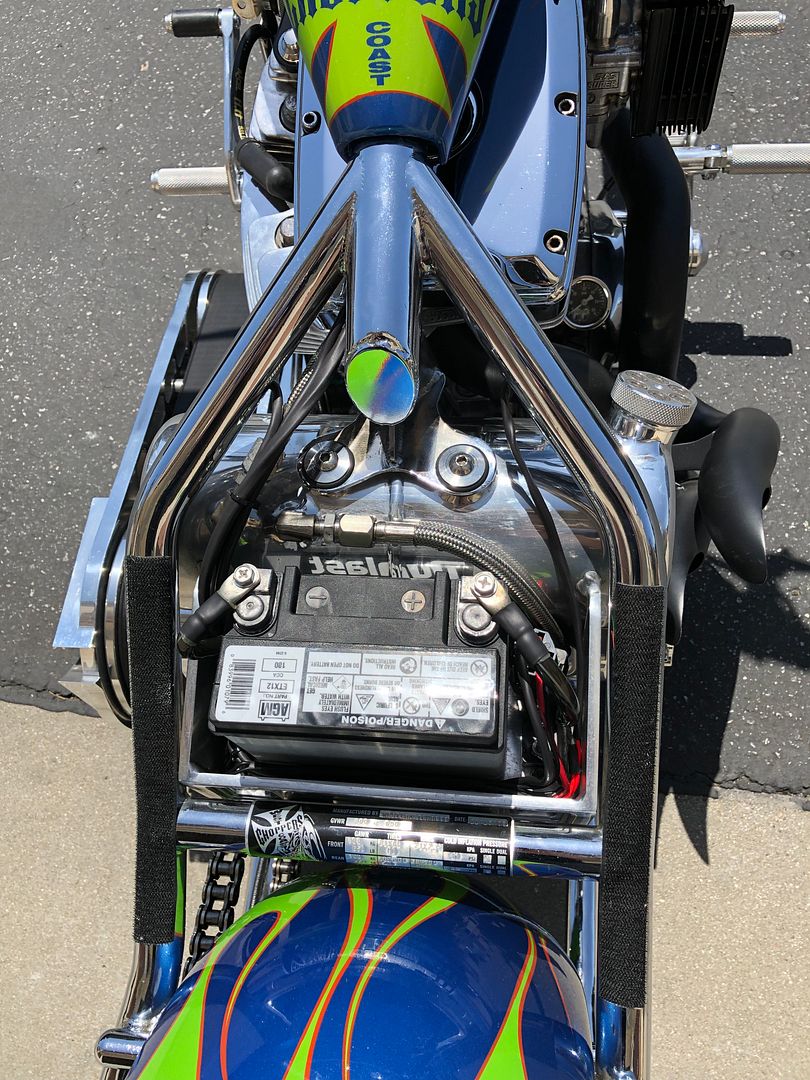

After months of planning and research I was able to put the battery in the battery box, I put the coil and regulator under the transmission and I must say I am impressed. It turned out clean like a shop built WCC.

You seem to have a lot more room in the battery box than mine, I hammered a piece of 3/4
soft copper flat and then bent it at 90 degees and down..I was able to hook every thing to
that and it works great, looks good man..clean work.
