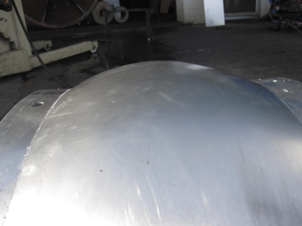

Here's a rear fender using same method. After I trim and and wheel the sides it should be good.

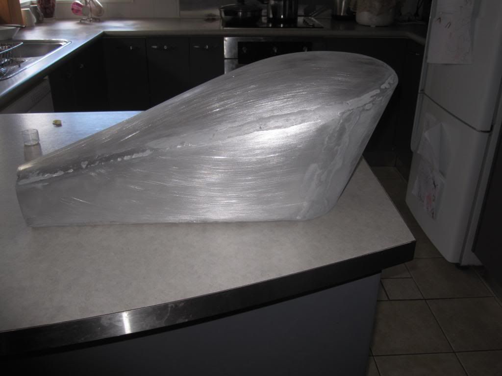

Tank under construction. Needs quite a bit more work but it's getting there.
This is the first curved tank I have made and the first Aluminium or Aluminum if you prefer to call it. I have made a few steel panel tanks in the past and they were pretty easy
This is quite challenging but I learnt a lot doing it and I think if I make more in the future it would be easier than the first.

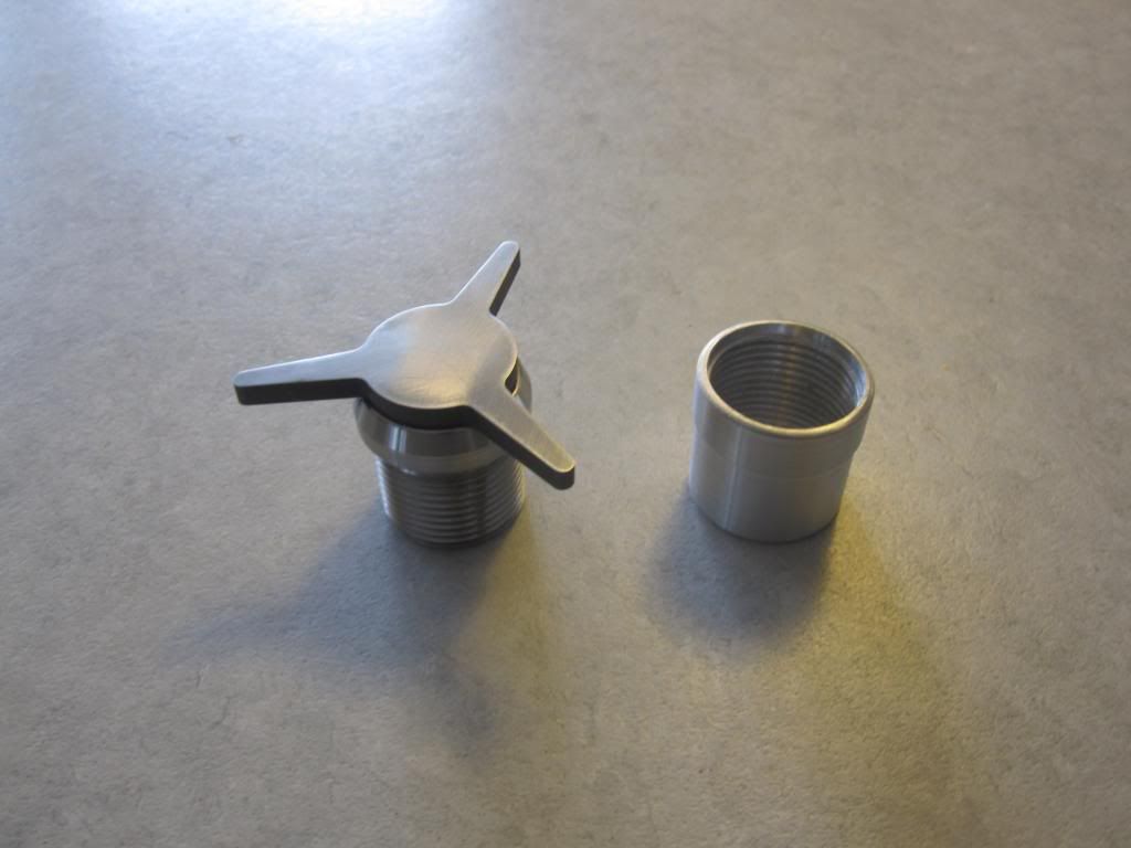

Made the filler cap and female bung to be welded into the tank when I'm ready.

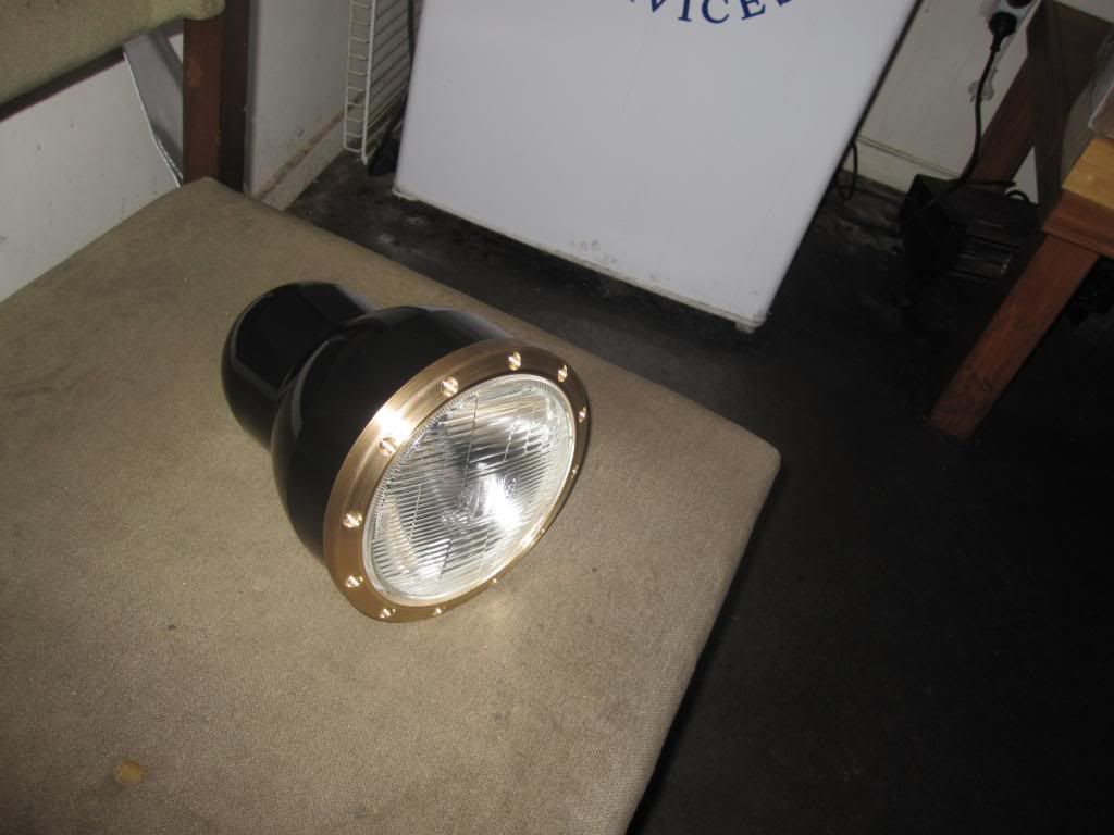

Back to it for a bit with some spare time here and there.
Made a headlight and need to paint it and make some mounts.

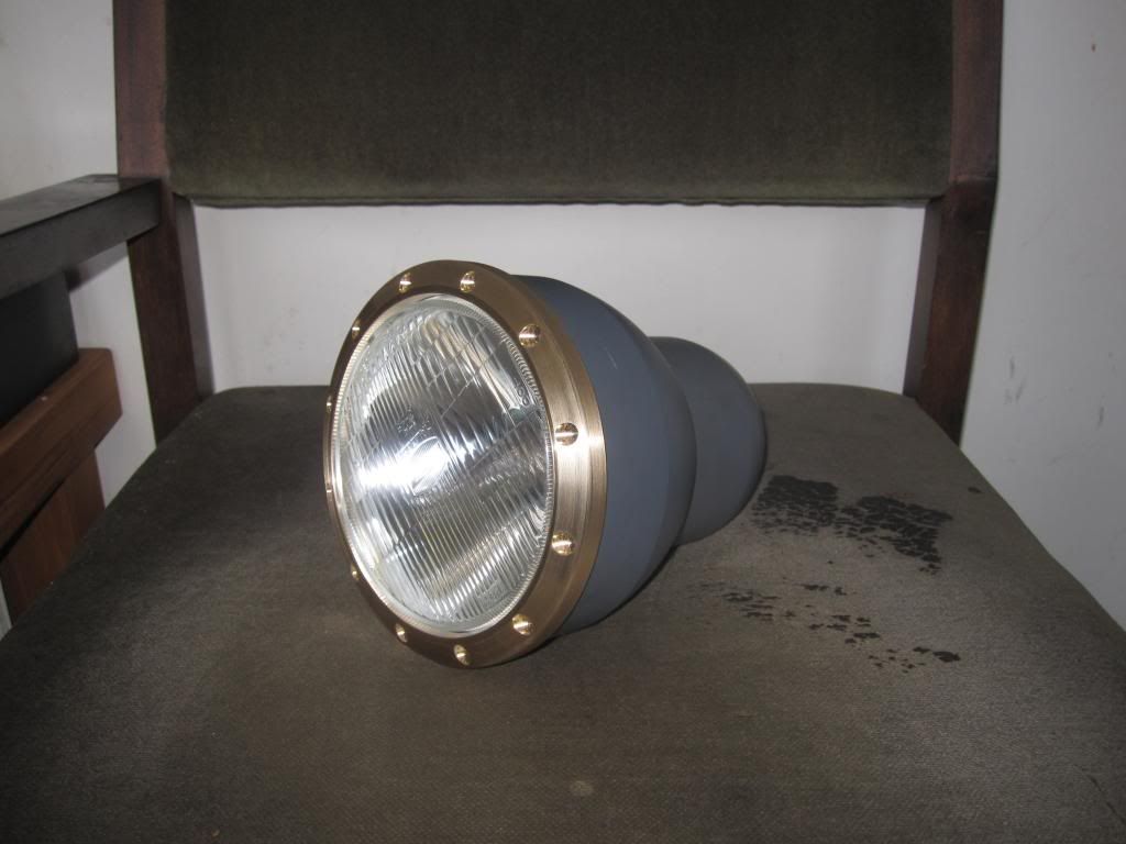

Painted it,

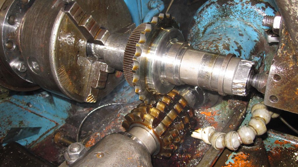

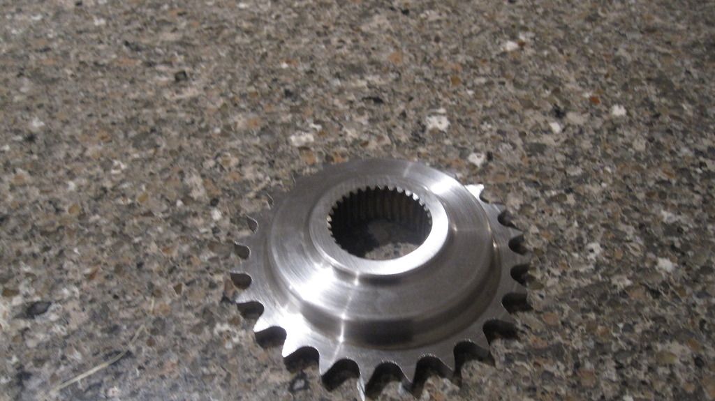

Made the drive sprocket.
Grab a lump of steel, machine the blank, wire cut the spline, gear cut the teeth and grind the faces, done!

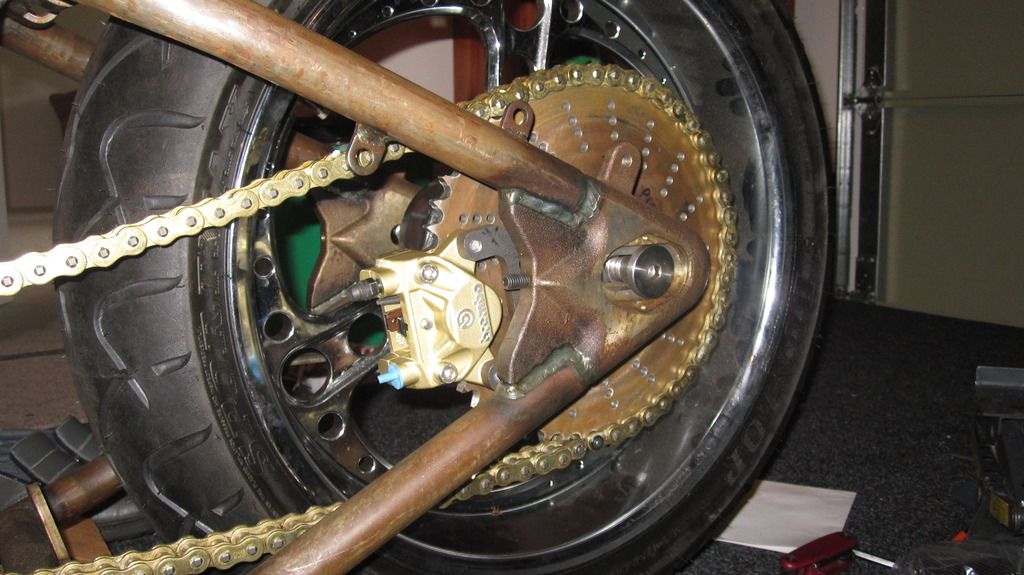

Posts: 166
Got the sprotor dummied up with the caliper and it all fits well with the chain chopped to a suitable length, just need a little bracket to support the caliper arm but I have that figured out.
I'll get the bits TiN coated (titanium nitride ) in the next week or so.

Posts: 3,186
Unbelievable job man.
It looks as if there,s nothing you can,t do.
Should I finally decide to come to work as a medical doctor to New Zealand( I get bombarded with invitations) , I would love to find you and learn from you as your apprentice.
