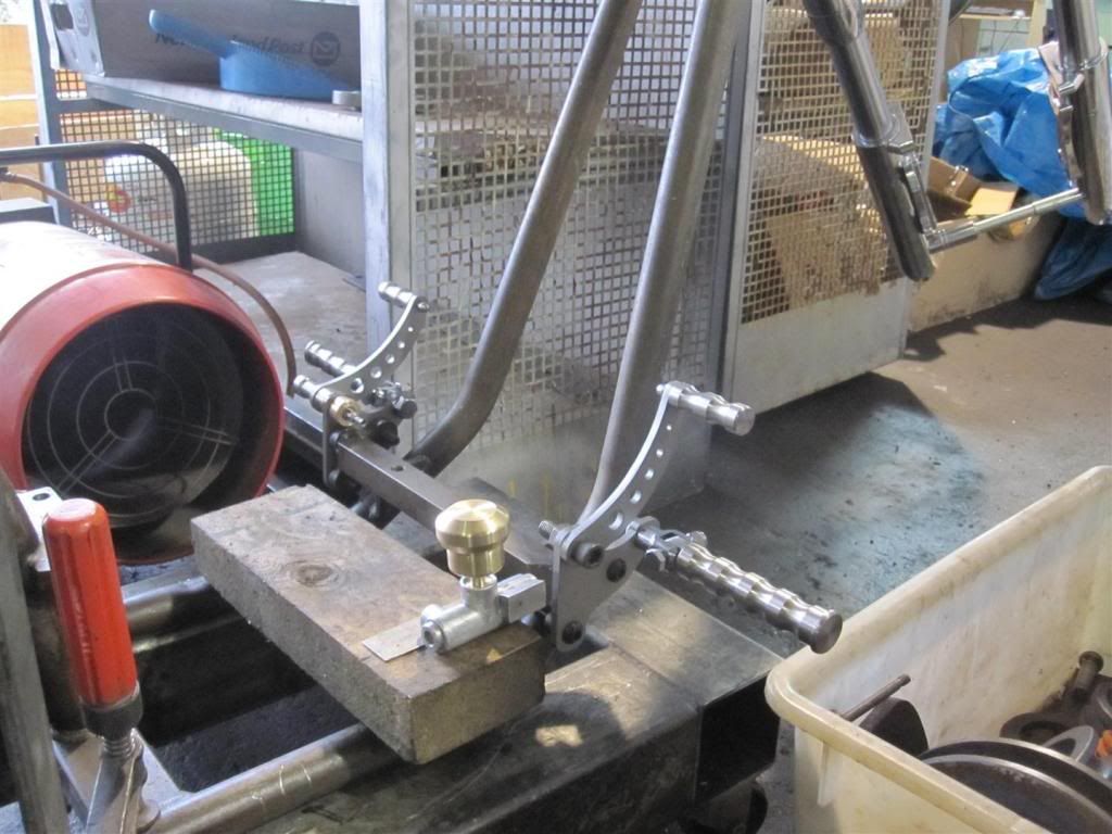

Got the controls mostly together but need to make some splined arms and some brackets, bearings etc.
Machined most of the brake cylinder and need to work on the mounting.
Also made an oil tank.

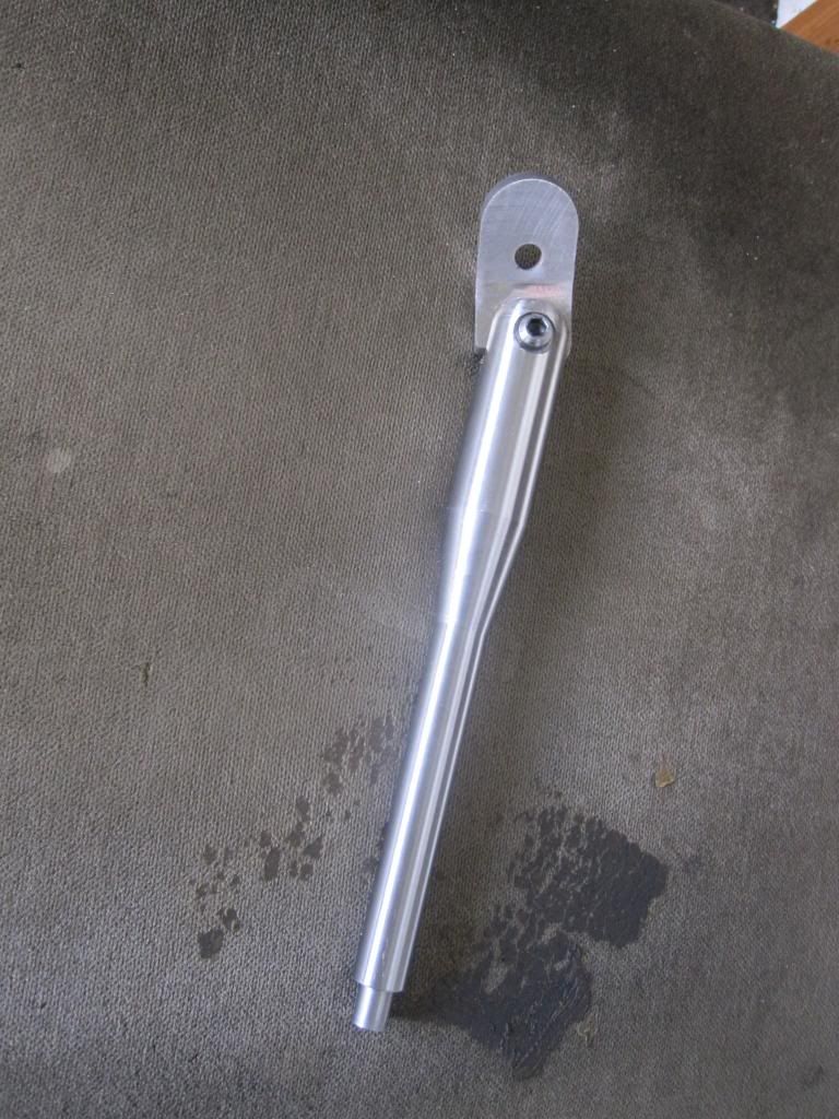

So today I made the makings of the side stand, it has an internal spring design .
The bracket is stainless steel and the leg is HT and I'll heat treat both to toughen them up.
It is not finished as I don't know the final length yet until I get the bike on wheels at which point I'll shorten the leg and make a foot for it.
The bracket needs another hole to mate it to the forwards, I also need to get a shoulder bolt for it but I mocked it up with a cap screw to test it and it works well.

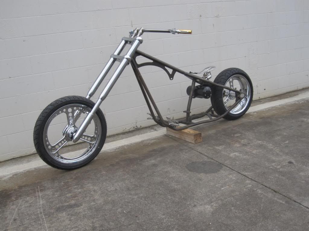

Was going to machine some wheels but I got a good deal that was hard to refuse so I pulled the trigger, it will also save a bunch of time.
Now I have the height I can finish off the side stand.
We often buy bits and pieces from some of the commercial auctions here and recently found a commercial powder coating unit with boxes and boxes of powder so I'll do the frame and anything else that needs doing, just need a bigger oven! I have a small unit at home but this is more advanced.

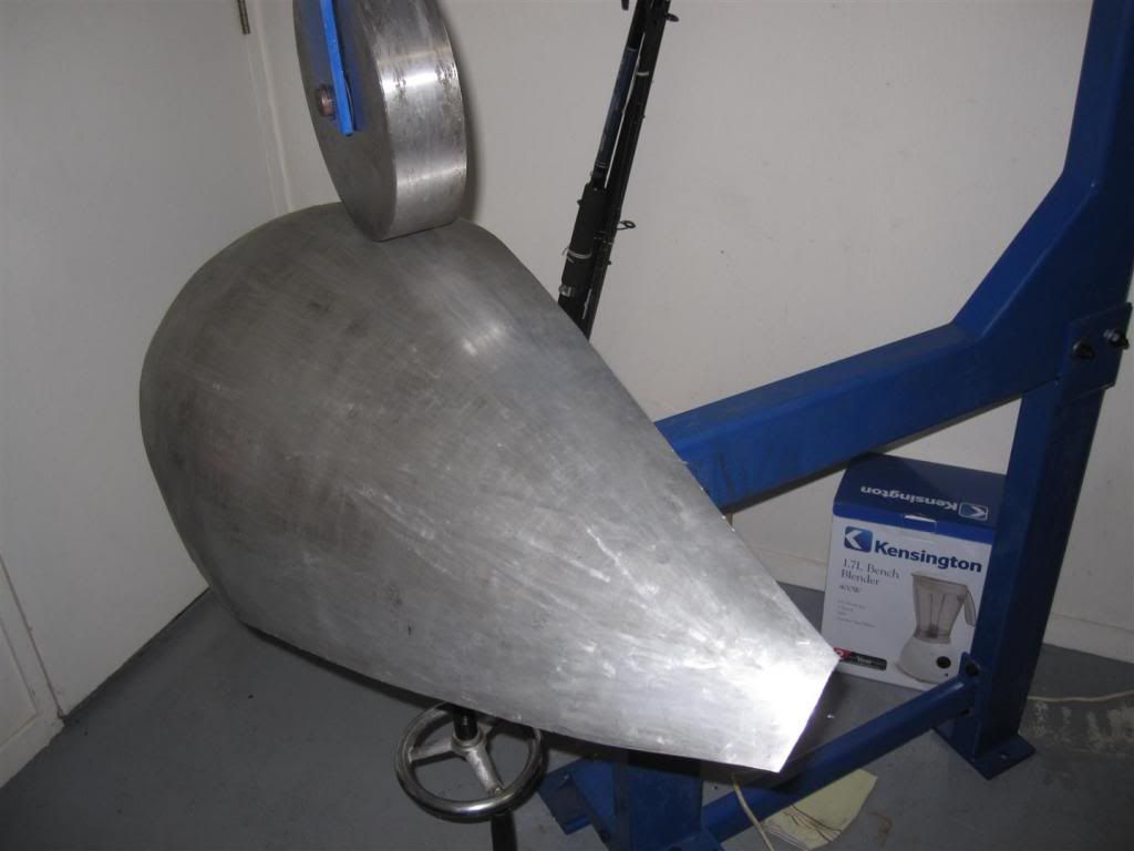

Cut out a cardboard template and traced that out on a sheet, cut it out, annealed it , bashed the crap out of it on a beat bag and then started to wheel it.
This being the makings of the tank, this obviously is the tank top.
It is starting to take shape but needs a bit more shrinking yet to the final shape.
I have blisters lol.
