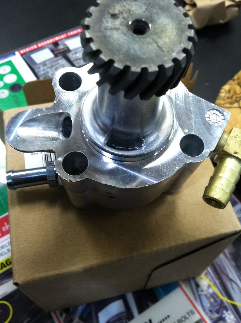

I think I might have found a significant contributor to my oiling problem. It lies in the style of pump I have. I'll post some pics when I can get them uploaded, and see what you think.

I went over to the HD dealership saturday, and checked out a 91-98 sportster oil pump that I heard others using on forums. Apparently, it's a pretty good pump. I wanted to see if the size, driven gear, bolt pattern, snout length, etc were the same as the pump I had (86-90 sporty pump that is called for). If so, I was considering running the newer pump. As I looked at it, I noticed that there was a scavenge port on the snout which holds the pump shaft, that would drain the cam well. My older pump, doesn't have one of these. When I took the 86-90 pump out of the motor tonight, 1-2 quarts of oil drained out of the cam well. The bike has been sitting for a week, and there was no place for the oil to drain. I think that the older style pump doesn't scavenge from the cam well, and there is no communicating pathway between the cam well, and the crank case. As a result, oil backs up into the pushrod tubes, and spills over into the head, then drains back into the case, which doesn't evacuate well with the older pump. I'm going to find out about the 07' buell pump, which is better still, (much larger scavenge geroter gearing, smaller supply gear) and if it fits, and has the scavenge port for the cam well, may give it a try. Thoughts?

I just got an e-mail, sure enough, can't get them anymore. I did talk to Rob, and e-mailed him my pictures of the 86-90 style pump I have, and that it doesn't have a scavenge port for the cam side, and he told me that for sure that is my problem. He assumed I had the later pump, the 91-98 pump. And yes, they are compatible, the main difference is the later pump has a larger scavenge gear, and a port to suck oil frm the cam well/block. As a result, I have ordered the 2007 buell pump, part number 26357-02. This pump has the largest scavenge gear, and is the best sportster style pump available production. I've ordered it through Rob, and we'll talk tomorrow to see if it needs to be modified at all. I will have to modify my frame for it to fit, but that's o.k., we'll get er' done. I want to ride it already

Rob, over at 2 Boss performance, who after calling and talking to a shit load of folks, is the Delkron guru. He's walked me through this one, and when I showed him my pump, was sure that was my problem. He used to modify the 91-98 pumps by making a thicker spacer and cutting down the width of the supply geroter. The 07 buell pump has done the same thing, except uses a standard width spacer, and made the scavenge gear thicker, so it has more suction in the cam well. I've ordered the pump from my local Harley dealer, and should be here tuesday.
This pump is taller, so I might have to modify my frame to get it to fit, but oh well, I just finished painting it. I'm pretty confident this will fix the problem. I guess we'll see.

Oh, the motor really was built for spirited street riding. The motor has only a few minutes on it, so the rings really haven't been seated yet. I had a quart of oil run out of the cam block when I removed the pump, no suction port on the 86-90 style pumps in the cam well.
