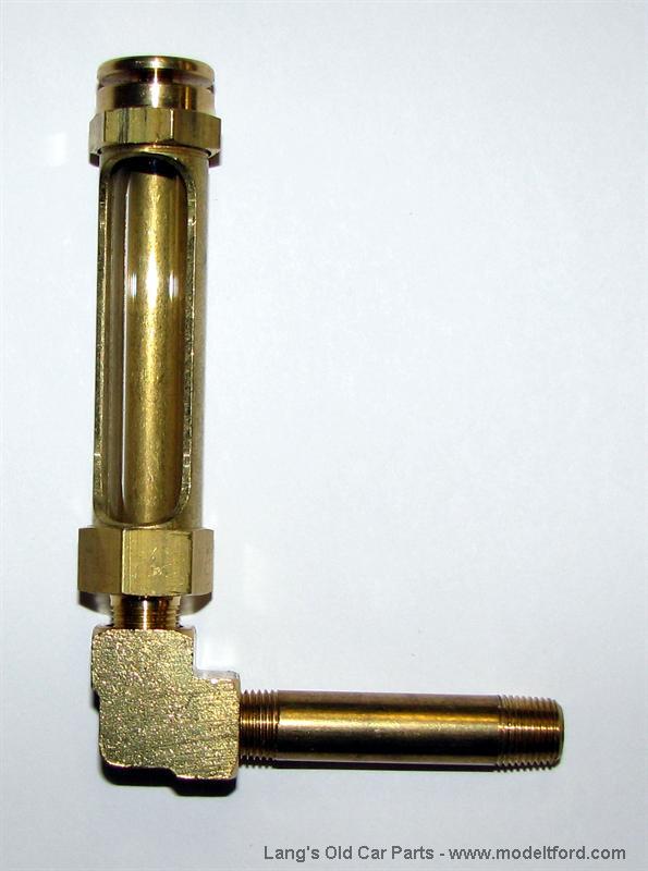

Found this one here in some CC threads... Looks like people do use them.. Its a LRC Brass 'Hardy' Oil Vieweing Window... DB, if you see this, where do I get one?... Thanks!

Looked on a chopper parts site and they wanted over $100 for the same part as this Model T site that only wants $30 Model T Ford Crank Case Oil Sight Gauge - Quality All Brass Accessory - MAC's Antique Auto Parts
Now the only question is how much will the level go up and down in the tank as the bike is started or shut off. Sight glass will have to be high enough to prevent over flow on top of breather yet low enough to get a good reading. Little more research into this before I order.

I would think you have to mount the sight glass, plug all lines with something, and fill the tank with 3 quarts of something, like rubbing alcohol. This would allow you to adjust height of sight glass without oil, or gas. my 2 cents...

Thanks rooter! As far as the hole, (bung), to mount the sight glass, it will stay in the same mounting position. Just will have to get a sleeve or spacer to possibly raise it up if I have too. I am think I will want to make sure the vent on top of the sight is high enough that the vibration wont cause oil from coming out of the vent at the top. The more I though about this today, the more I think it will look kick ass on the bike. And if I happen to not like it, plug it....
