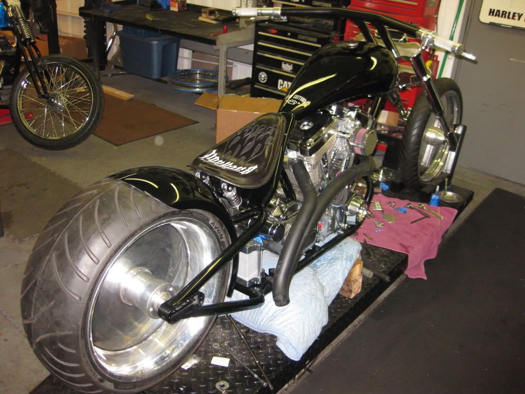

I've got a custom with an Ultima 113 in it. I realize I'm not going to get the HP out of the sporty that I do out of the Ultima but I'm looking to get as much as I can without getting too radical and spending too much $ . I'm a rather large fellow at about 290lbs so I need a little more pep than some

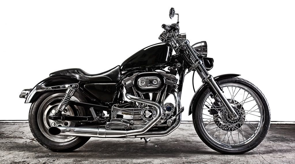

Im 250lbs and with a basic conversion you can SMOKE Twinkie's and BT's......Hell people don't realize a STOCK 1200 is the 2nd fastest and quickest Harley makes...(second to the Vrod..) If you want to push the envelope get some late model 1200 heads (stock is fine),N4 cams and a good exhaust and you will be pushing 80hp with a good tune...(Been there done that.....)
Im pushing well over 80 DYNO hp as it sits now...BTW my current build is using a 113 ultima also!
My Sporty...
- A Society that will trade a little liberty for a little order will loose both,and deserve neither - Thomas Jefferson

nice looking sporty

Thanks...My current build is running a 113 Ultima also...Shooting for end of the month to fire her up!!! (wish me luck)

another nice looking ride
