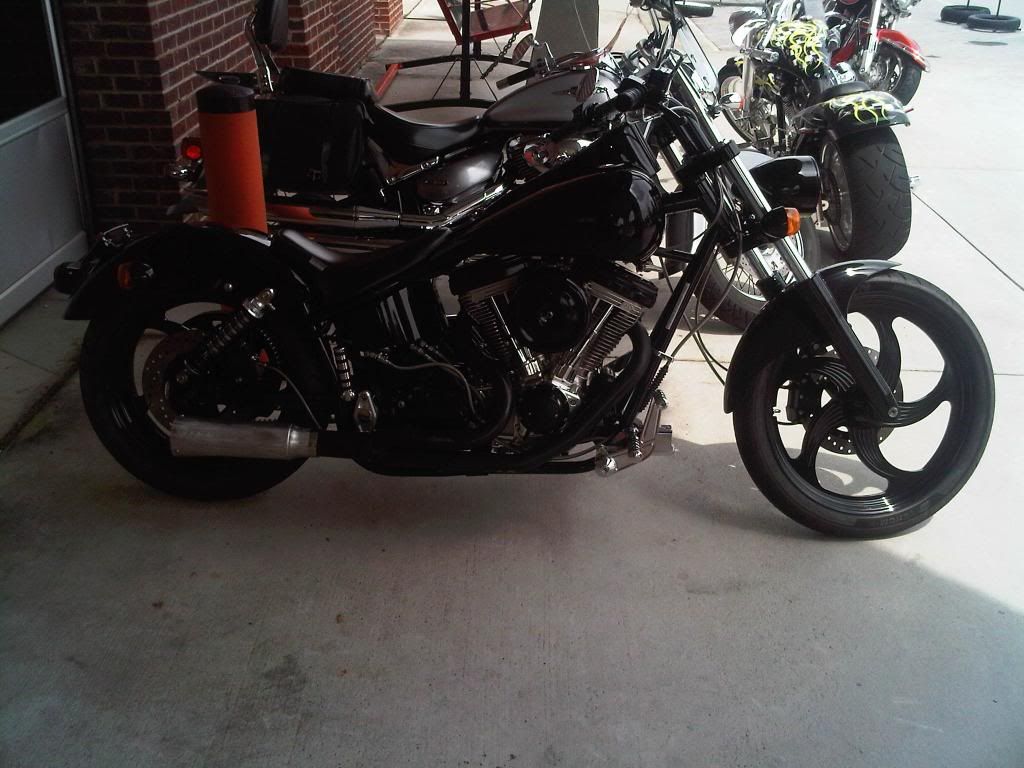

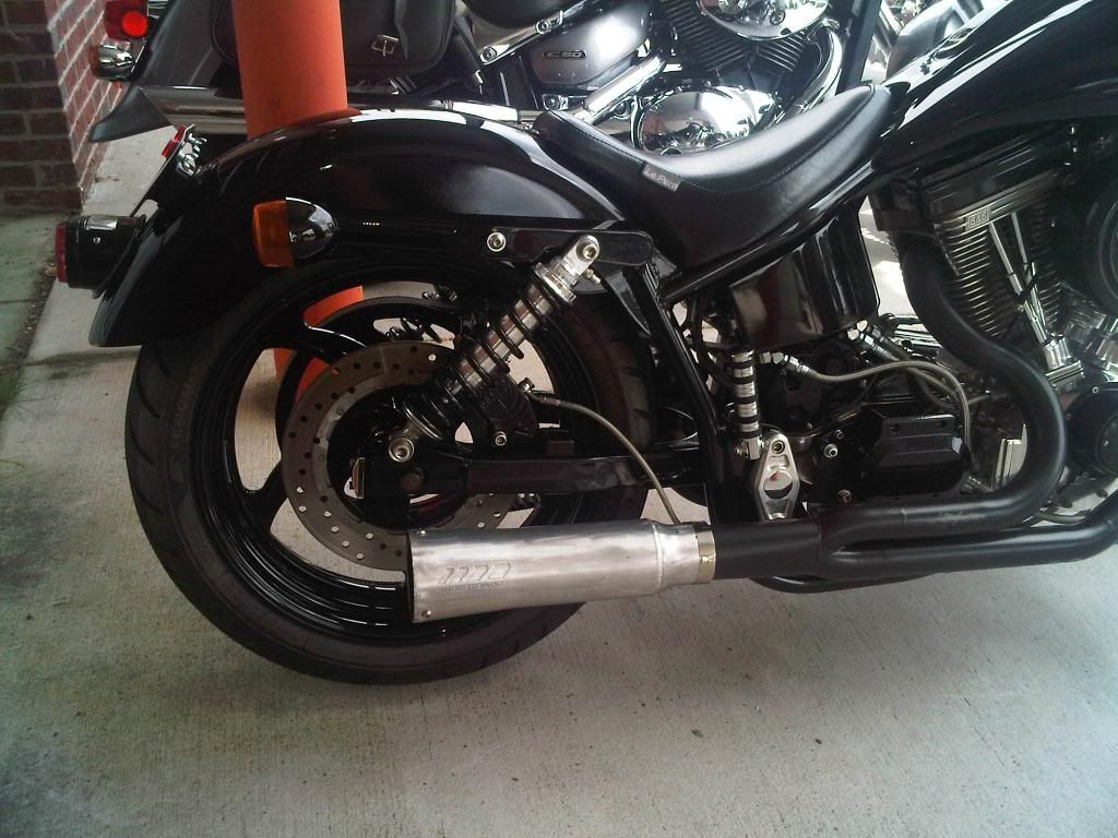

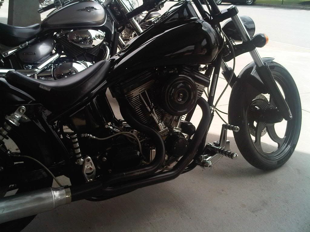

I saw a Iron Horse bike that is based off the same frame and it runs a 180 with a belt but the swing arm is wider than mine and the frame may be a bit wider, but didnt have a tape on me that day to measure. Did take a bunch of pictures though. I think they said the IH was a 99 but dont remember the name of the model.

Post the pics we can figure it out, I have seen a roadster with I think a 10 Ironhoarse Roadster I think

[IMG][/IMG]
[IMG][/IMG]
[IMG][/IMG]
[IMG][/IMG]
Old 09-21-2010, 08:40 PM
Posts: 10,371
Looks kinda like a drop seat frame possibly a dyna. Maybe a fxr boyde frame, maybe
