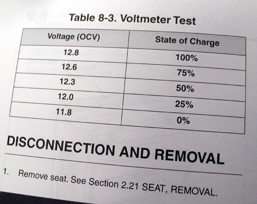

The bulb is a H4. The voltage was taken on the wires with the bike off reading 11.7v - The readings with the bike running and the throttle up a little was 12.9v
What is the voltage supposed to be with the throttle up? I was thinking its a high voltage problem or possibly the vibrations knocking the bulb out?

Normal voltage with a fully charged battery is 12.75v
Charging at 2000-2500rpms, should be around 14.25v
So, you're battery is low - to start with
