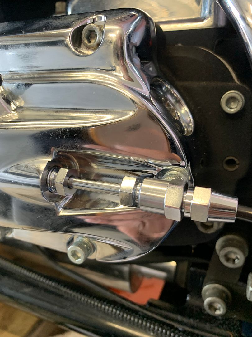

I'm currently building full custom Vicla Softail Deluxe running all Russell Pro II lines and fittings for Brakes and Clutch, purchased off John and Scooter Performance.
I am using fitting R4344C which is then attached to the Goodridge Hydraulic Clutch Adapter Part 602-03-04CH.
It is at this connection between the two parts where the fluid is leaking.
Any ideas or suggestions folks? I am stuck.

I've never seen that straight fitting before. We always used Banjo fittings for the last connection into the actuator..
