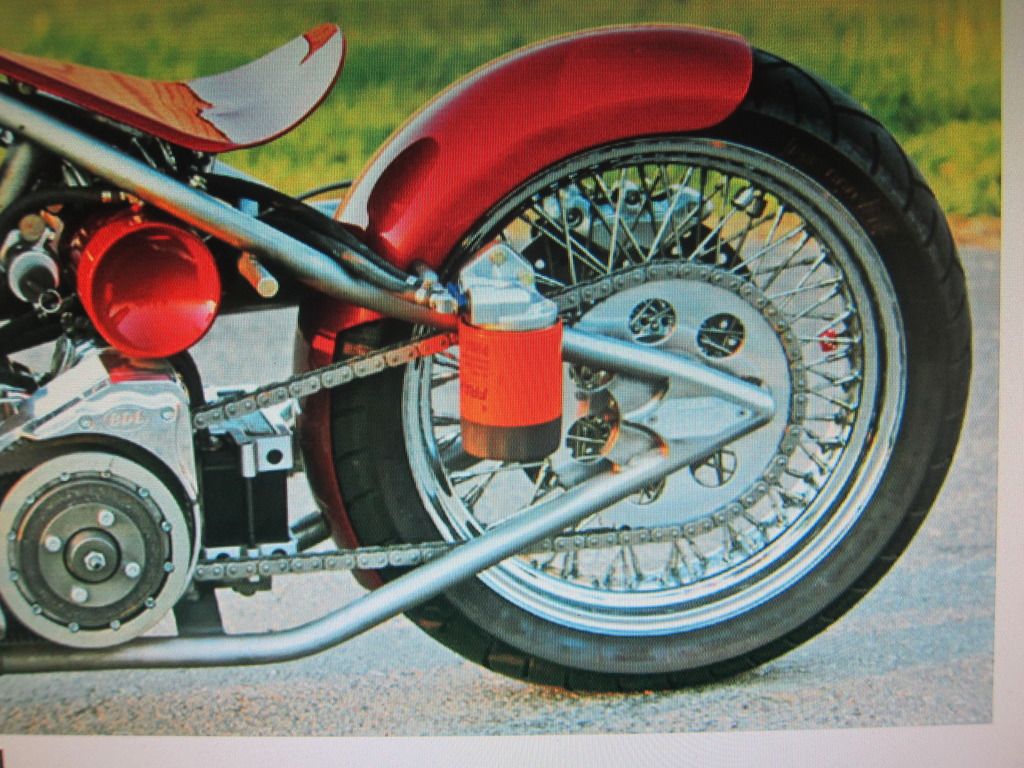

I purchased a bobber on Sat that has a twin cam engine. The builder had a second oil filter sitting on the frame next to the rear sprocket for extra oil and cooling. Somewhere along the way this was bypassed and removed. I'm thinking about adding a oil cooler in the same spot, one that bolts to the frame like the Pro One.
Do you guys see any problems with it? IMO, the bike needs the extra oil for cooling. I know its not mounted up front for better cooling but it seems like this would be the best spot since the line are already there.
Do you guys have any suggestions?
Below is a write up and pictures about it. I tried loading a couple pictures but their way to big.

The mount and filter are no longer there.
sorry, the pictures are just too big and I don't have the talent to resize them. I'll keep trying. Photobucket is more like bucket of shit

Sounds like you would be just fine....I have a home made cooler made of 10 feet of copper tubing mounted
under my transmission, It does an amazing job..

I think the oil cooler is a fine idea back there, I have that style on my shovel, Wimmer Machine makes them in several styles with a variety of finishes and frame clamp sizes...

That oil cooler isn't restrictive at all, it's more or less a small oil tank with fins. In general the Evo and TC flow about the same amount of oil, the TC pushes the oil at a higher pressure.

I agree, once I had the air bled out of my roll of copper tubing, you could easily blow the oil through by mouth....it's the air in the line that makes it difficult..be sure to bleed all air out before cranking her..no problem for an oil pump.....If I remember, my oil temp. dropped from 190 to about 163 degrees
