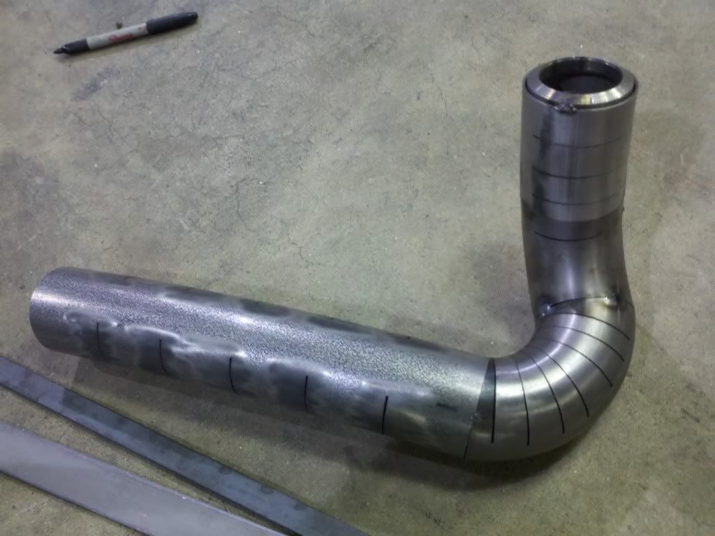

Welded the modified oil tank back on. My legs still rest on it, I'll have to decide what to do when I first ride it. If it gets too hot I'll make some little heat guards for my legs to rest on. I've got it dropped as far as I can without interfering with the starter. All I can do now is tilt it forward to get it lower.
Next was to make some exhaust pipes. This was my frist time making a whole set from scratch. I bought a shitload of mandrel bent sections but only ended up using a single 180. I cut the headers off a set of trashed VH Big radius I had laying around, and made these bungs to step up from 1.75" to 2.5".
Yeah I know the pipes are gonna turn blue and no baffles so I know they will be sick loud, shoot fire, and kill my low end. I don't have shit for brakes on this thing anyway and I like fire coming out of my pipes.
I had a section of straight pipe roll bent into a 10' diameter for the long pipe, but the bend still wasn't enough. I ended up slotting the pipe and bending it tighter. I used this throughout to get the fit I wanted.
Before...
