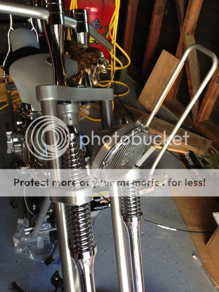

I scratched my springer fork legs a bit trying to get the powder coated legs through the triple tree. I spread the tree but there was no avoiding scratches. The PC is thick! My question is can I buff out the scratches? Any technique or product I can use on PC? It's metallic silver with clear coat. As far as I know, the clear is also PC. Can't see in the pic but for reference.

I've buffed it before like I would aluminum. Used metal polish

Nice lookin' rig, man!!

yeah it is. i was hoping to see more pics of it, but your photobucket album is private.

Lovin the skull, where'd that come from?

depening on how deep it is we start off at 800 grit, then go up to 1500 grit. buff like you would paint from there. We use 3m finess products

A special spray is sold to put on dull powder coat to make it shiny again.

yes you can buff it out , after buffing you need to start the PC from scratch .
