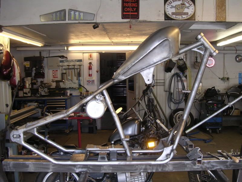

Thought I would stick this pick in here. It's a 4"up CFL. I raked the neck out, single down tubed it, cut the batt box off the oil tank, moved all the fittings in the oil tank and added another mount, added a batt tray, sectioned a Villian tank up to narrow and shorten it, as well as rounded the top side a little and dished in the sides. It's a current build in the WCC forum, Shane Gatto (Rootbeerfloat) is building it for Rob of Rob's Cycle. More detailed fab. pics of this build will show up in here as time goes on.

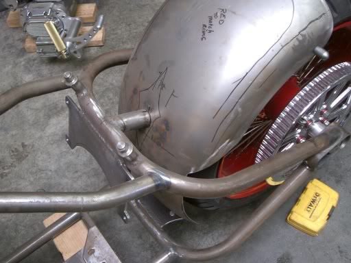

Here is a super clean rear fender mount I made. I took a washer and tacked a nut to it. Then I welded the washer to a piece of tubing with the nut on the inside. A couple big fender washers and a bolt from inside the fender and done.

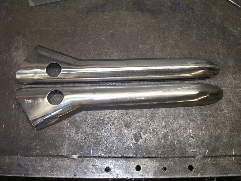

The latest project to be completed in the shop, an '06 Sportster getting the 240 tire treatment. Lots of fab work on it. I'll post up my favorite part of the job here, and you can see the entire build here. Click on the "bikes" page. Projects
Here's the strut covers I made to fit over the new struts I made. The covers were a combination of 16ga exhaust elbos and 16ga sheetmetal. They will be chromed.

nice work oilburner.

F-IN A!!!! man does your work look GOOOOOOOOOOOOOOOOOOOOD!!
I may just havta forget about making my own tank, and send you the specs and have YOU build it for me.....

Thanks Punisher, I like to do stuff nice enough to make someone feel bad about covering it with paint, lol. Thanks for the compliments!
