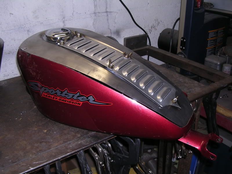

Tank pictures...
Thought I would start a post of tanks I've done, I'll add them as I do them. I have LOTS of pics, so if someone wants certain pics of something (like maybe "How did you make that side?" or questions like that) just ask and if I have close ups of what your asking, they'll be posted. Some of these pics are on my website, some may not be. Enjoy!...
Here was a month leading up to a show I was going to display tanks at, so I was building up inventory for a display.
This is a tank I did for a customer in Virginia, and in the second pic you can see that he sent it back to me to have it modified to contain an oil tank in the left side... Very cool project!
Here is a slender snake like tank, it's hard to get the full affect of the double radius on the top but the light catches it a little.
Here's another with a double radius top, this one shows up much better!
here are a couple modified sportster tanks...

Very nice. What did ya use to get the double radius on the top of those 2?

I can do any tank you can think up. The best way to do a scratch built tank is building off a foam or wooden buck, but I can do them off of drawings and measurements too. I am working on a series of pics on how to make a buck also, should have a couple pics up on that soon.
The double radius's are all time on the english wheel, anything you see with a body line/stepped edge I do with a bead roller. I either space the roller dies accordingly for what I want, or make special dies/have them made. Thanks for all the feedbacl and compliments, Mark.
