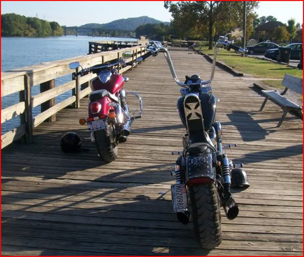

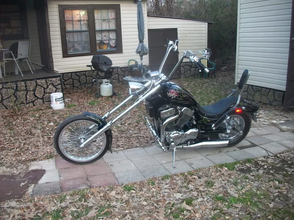

I just noticed your post tonight and thought I'd show ya a few pix of mine , an 05 1400 .....I bought her new in 05 , since then I've added a raked front end (AME kit) it comes complete with the choice of overstock length tubes (I chose 10 in) .....I put on progressive 412 shocks ,forward controls, built a fiberglass seat span, 15 in apes , since these pix were made I've changed to a homeade sidemounted tag......I have youtube clips also just holler & I'll post.....the exhaust are torched out and repolished to remove blue- ing
this is the widest tire I have fit under her, it's a Kings 120/80 15 ......on the subject of wide tire kit .....Thunderbike (German website) sells the kit for intruders shipping and all about 4 thousand, it involves a double u joint drive shaft and diff swingarm ! (OUT OF MY BUDGET !)

here's a couple more pix......some were with a windshield , now it's got apes. in some pix I had the stock 19 in frt wheel .....now it has a 21 inch (I bought one from a member of intruderalert from an 800 intruder)....it's an easy swap ! (JUST HARD TO FIND ONE)
GOOD VIEW OF MY HOMEADE SISSYBAR
my first homespun seat attempt
this is how the seat looks now (except I recovered it in black suede)
my tank art
reservior covers I fabbed
oil cooler screen I made
at the city docks
