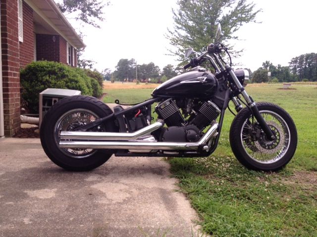

I bought this V Star 1100 brand new in 06. I rode it only 8000 miles or so in the next few years. I lost my job in 09, moved to a different state, and was unemployed for a year. The bike sat a lot.
I never really liked the rear fender on the bike, but I did like the 18" front wheel and the 170 rear tire.
I took this picture the 2nd day I owned the bike. Probably not even 10 miles on it when I took this picture.
Along with hating the rear fender, I hated the bars even more.
I lowered the rear suspension in 2007 right before we went to Americade. New drag bars too.

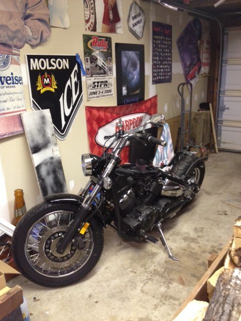

Fast forward to February 2014. I had a few days off work due to a snow storm in Raleigh. I spent some time in the shed taking parts off the bike.

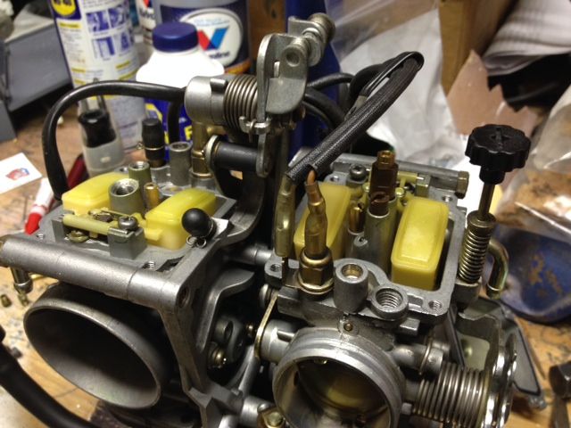

Pulled the carbs apart to re-jet for K&N pod filters. They were pretty gummed up. Apparently I didn't completely drain the carbs last time I ran the bike.
Big K&N RU-0600 filters. They fit under the tank and I don't have to run the factory filter housing (dog bowl) either.

I put some tape on the frame & made some marks.
I always thought I would have a hard time cutting a perfectly good running motorcycle. But technically, it wasn't actually running at this point in time. I got the angle grinder out & let it eat. Probably not the preferred tool, but it's what I had.

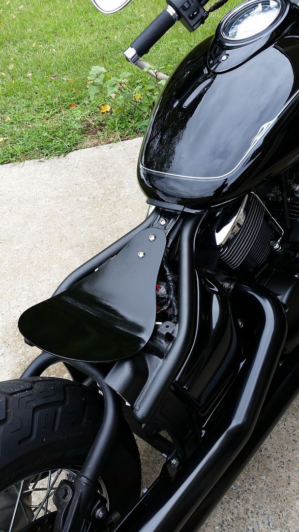

I gave up on the trailer spring seat mount. Rattle can painted all the plastic and the pipes. Ready for inspection & tags.

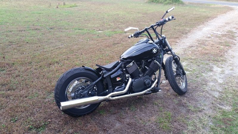

Just back from NC inspection. November 2016
Old 03-12-2017, 07:29 AM
Join Date: Nov 2016
Location: Raleigh, NC
Posts: 5
Just some updates to my bike
