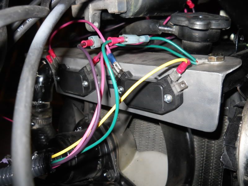

Posts: 666
Since I now know it works from testing:runnin 001.AVI - YouTube
I replaced the Honda ignitors (with a going rate of about $125 a pop)
with a pair of these (with a going rate of about $15 a pop)
The chevrolet modules will also replace the ignitors in the Cb650, CB750 twin cams, CB900, and CB1100 (marked OKI MPS-200). Pretty much any Honda with mechanical advance and electronic ignition. They won't work in systems with electronic advance. Its nice to know if you burn a module you can pick one up cheap at any auto parts store and be back on the road. I also mounted them tight to a big chunk of aluminum so the heat sinks can cool. The stock ignitors needed a ballast resistor so they wouldn't burn up, the chevy modules don't.
Here is a quicky diagram I drew up on how to wire in the chevy 4 pin modules.

Just a couple of pics. Doesn't look much different than it has for a while, accept that things are bolted together. There is also a pic of the Chevy modules. The wiring was just a temp job so I could make sure that things were gonna work out,,,, and they did.
20 years ago, I would call in sick and have it done in time to run to town by dark.
These days, I'm just proud of myself if I can spend 10 minutes a day wrenching on it.
