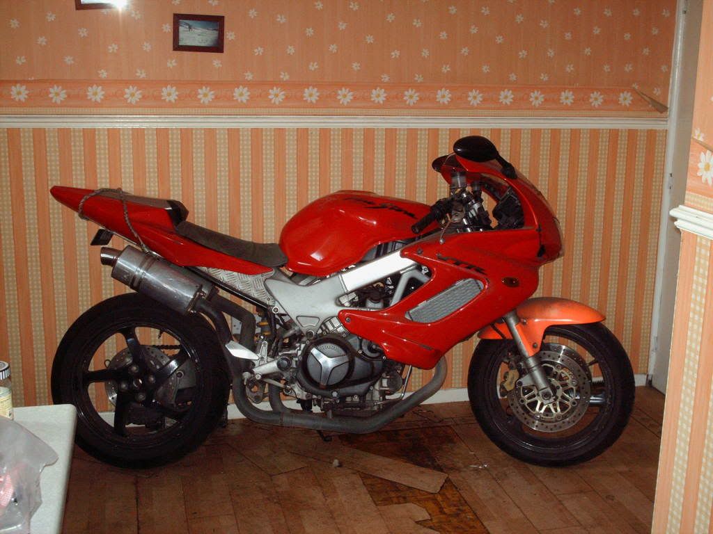

I bought this about 5 Years ago as a Scrapper and built it as it is now to go to the TT on.
I fitted a VFR Swingarm, modified the Rear Downpipes and used an R1 Seat unit.
It was once quite tidy but in 2006 I got knocked off it by a Chelsea Tracker and it was Mashed.
I roughly rebuilt it and just used it as a Daily Hack for a while but Shortly after I bought a 1200 Bandit
as Daily transport and this has sat in the Back Kitchen ever since.

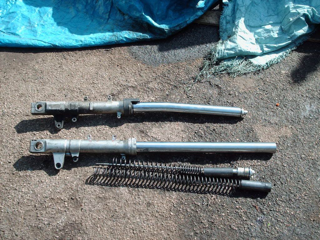

The Bent Legs are the ones I Splatted in the crash and the new Stanchions are a 41mm Trail bike pair cheap off Ebay.
The plan is to turn down the Fork Tops off the VTR and fit them inside the Longer Stanchions with a Spacer tube in the top.
This way I can keep the standard Road Springs and still have Damper and Preload adjustment. The only Problem is, I would
have to take the top nuts off everytime I want to change it.

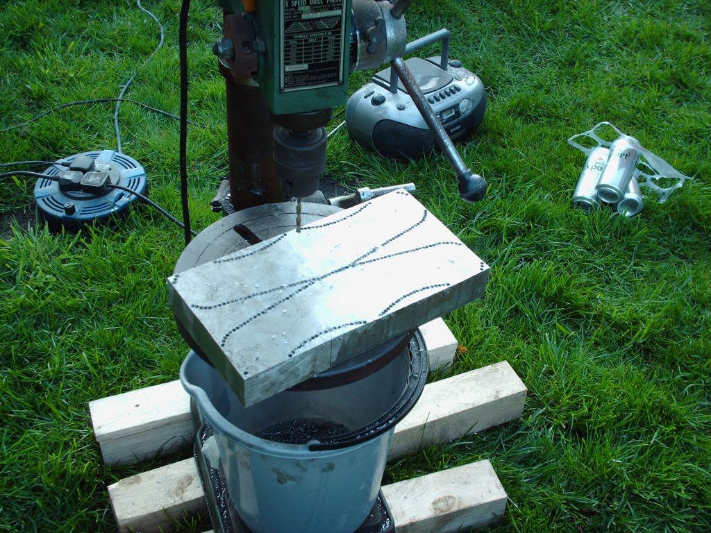

I Stated making these Yokes a while ago for one of my Trikes but never finished them. They will be perfect for this Job.
I cut this Slab as best I could in a Chop Saw and started to work out some sizes for a set of Slabs.
I can't think of a faster way of doing this with the Tools I have, but if anyone has a better idea
I'm all ears??
I have never made Yokes before so this will be a learning curve.
Spent most of yesterday drilling holes and drinking Beer.
I got the Yokes separated after about 6 hours.

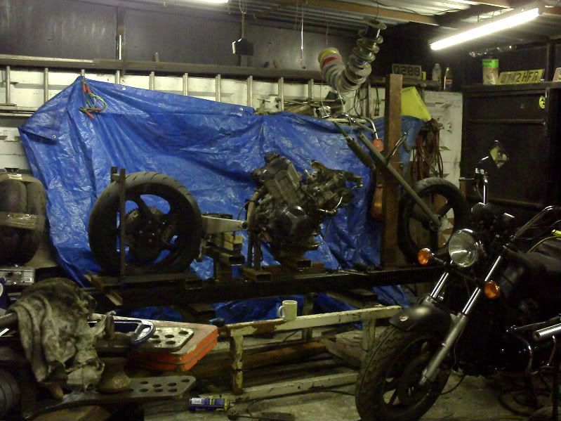

I have got the Engine and Rear Wheel Bolted down and aligned, Forks have been assembled, Headstock turned for bearings, just waiting for a big piece of Stainless to make the Engine mounts and I can Start wrapping a Frame around it.
I suspect, I might have screwed up it's great handling?
