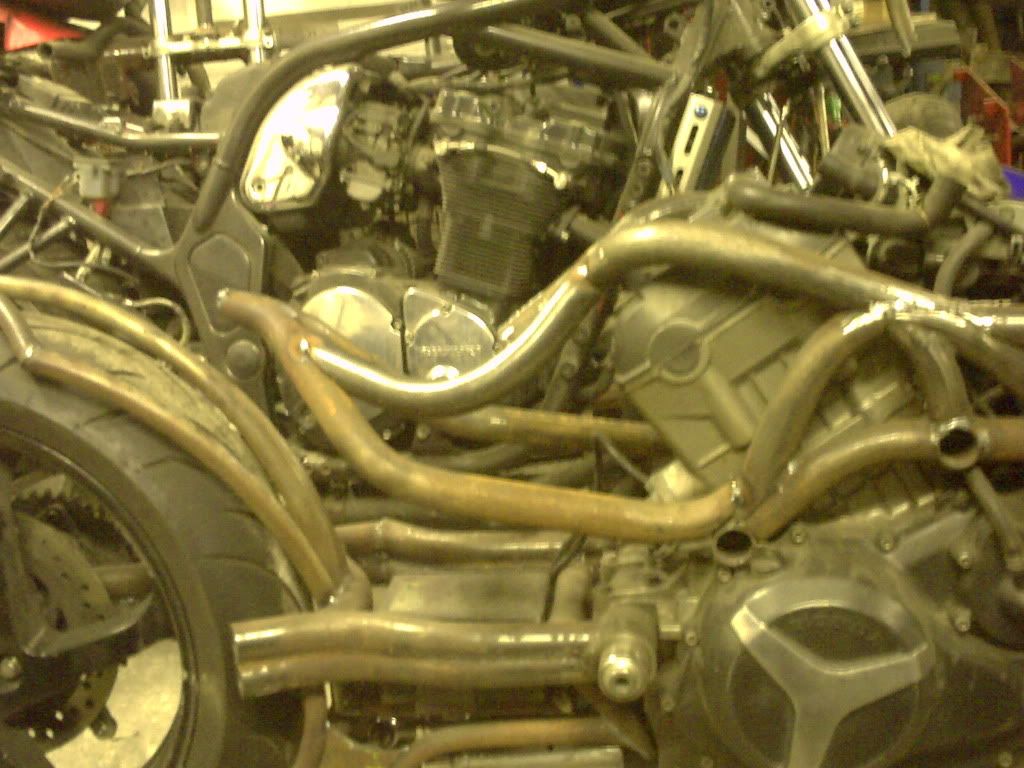

Next job was to Bolt these parts to the Engine and Rear Wheel to be joined together.
Again I will be making it in Tube using inspiration from my Friends in Thailand.
I had the Engine and Rear wheel Aligned on the Table using the original Swingarm, bolted them down to keep it all straight then removed the Swing arm and slid the Wheel back in to the position I wanted it.
Double checked the Sprockets with a spirt level and went for it.

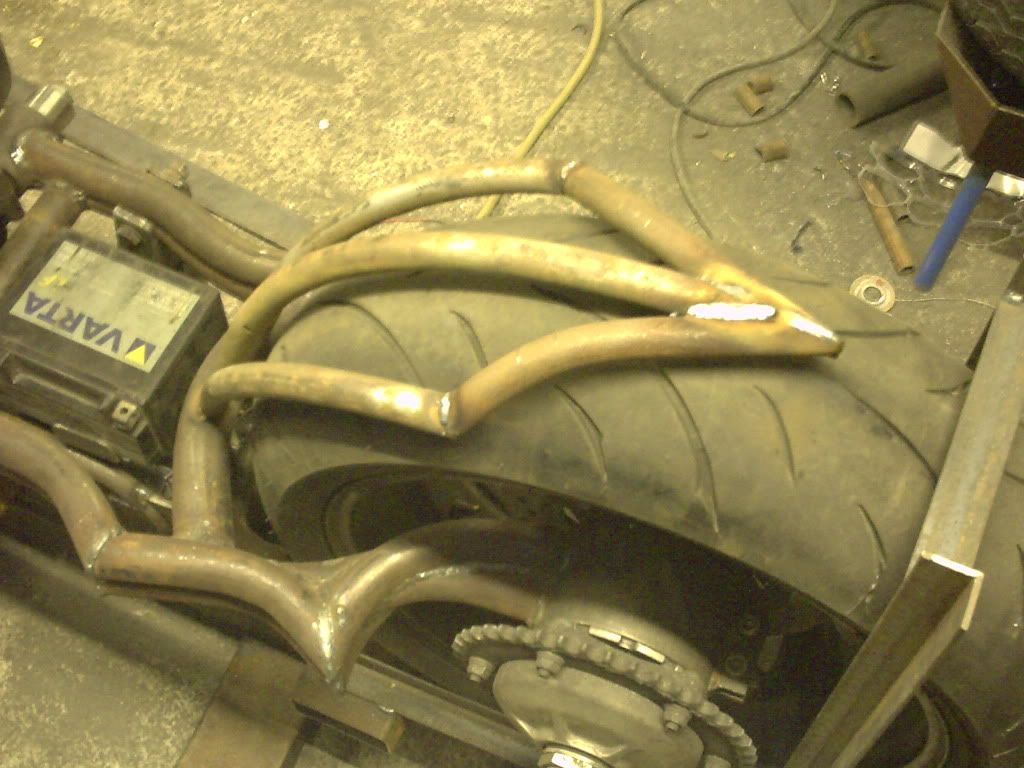

I've done a bit on the Riders seat over the weekend.
It was only 4 pieces of Tube but it took me 2 full afternoons and I nearly cut the whole bike up at one point because it was pissing me off.
I eventually got all the Bends right in the end and then the Argon ran out just as I was about to Tack it up. :evil:
I picked up a new Bottle yesterday, stuck it together and it's worked out alright.

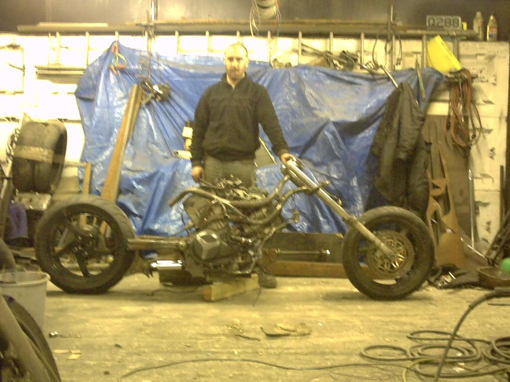

I need to have a little break for this for a couple of weeks as it feels like I might burn out on it.
A mate aproached me the other day and asked if i could do a few Jobs on his VW Trike.
As it turned out the Trike was so badly made in the first place that it is too dangerous to be on the Road.
The Headstock is just a Large portion of an XS750 Welded on to a couple of 1" Tubes and a piece Scaffold Pipe.
They have left half of the VW tunnel in there and hidden it with Plates.
The Frame Bends when you press the Break/Clutch Pedals.
The Front Wheel runs 2" off centre.
The list goes on...........
These Pictures show my mate (Macbeth) and the Trike as he brought it to me and my rough Mock up of how it might look.
