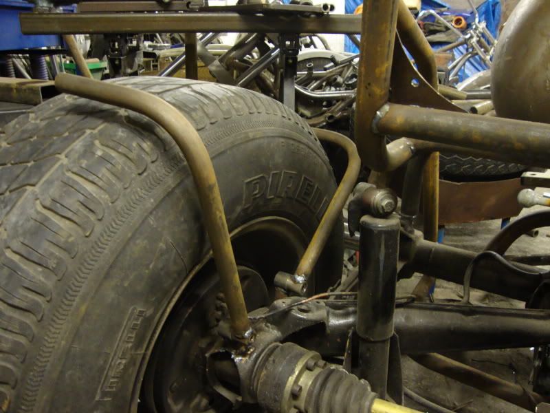

I've been working on the 2 Trikes for the last few nights but there not too much to show just now. I've widened and beaded a pair of rear guards and made a load of bits in the Lathe to mount them. I'lll get some photo sup once I get them fitted.
If I can get one of them out of the way, I'll have a big hit on the VTR as there will be more space in the Shed.

I don't usually update the trike stuff that much because they are not to
everyones taste and I've found I end up talking to myself on the other
forum I'm on. I did a Trike rescue once that barely got a single look, so normally
just show the highlights now.
I have nearly finished making all the stays for the rear guards now which is one
part of a trike build that I hate. Also it is one part which people normally screw up.
I've lost count of the times I've seen someone at a Rally trying to tie a busted
guard back on because the stays have sheared (myself included).
The guards have been widened by 50mm and beading added to the ends to
finish them off.

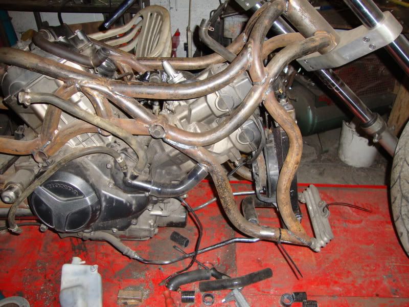

Managed to get ahead on the other projects so my bike gets some time on the bench.
I've started looking at the water pipes. I will put them through the frame where I can,
just got to work though it one at a time.

Originally Posted by Trikeopath View Post
...I've started looking at the water pipes. I will put them through the frame where I can...
Soooo am I understanding it right that you mean to run the water through the frame to take it to the radiator with minimal external piping?
Will you be sleeving the frame with an internal rubber hose? This build is just getting cooler and cooler.
No Mate, the anti-freeze mix has anti corrosion stuff in it. Same as you would use
on a cast iron block to stop the water jacket getting blocked with rusty sludge.
You can't see too well on the picture, but I have also blanked off both ends of that tube and filed the welds out.
This is not a new idea. I've seen loads of stuff done this way. Chris Ireland used to build his V8 Trikes with water
in the Frame with no problems and he built hundreds of them.
