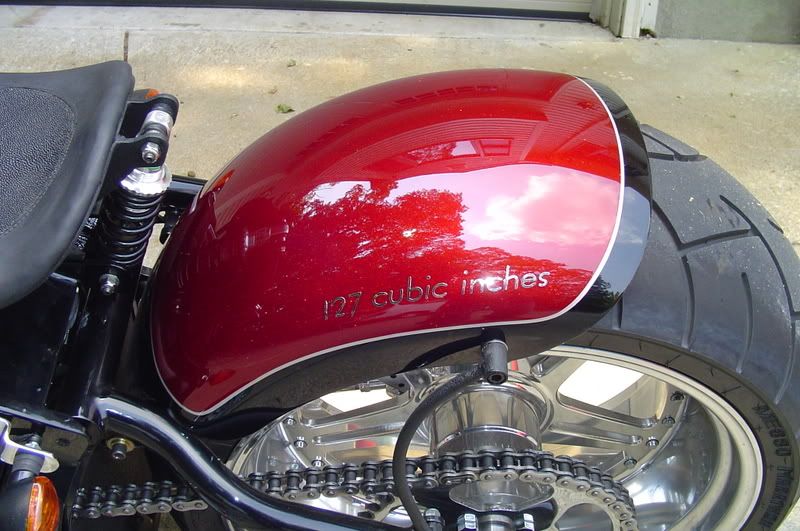

You really need to wet sand those runs. It's worth doing even if you have to re-spray the clear coat. Sand the runs to where it's smooth and just scuff the rest of it with 600 or 800, then re-clear it. Obviously, you're spraying too heavy. It doesn't take that much to cover it. Stop spraying as soon as it looks wet. Let it set up for about 20 minutes or so to the point that it's very tacky and makes a string when you touch it. Then spray it again. After it's dry, you can always wet sand it with 1500 then 2000 and buff it. That will take care of any orange peel and it will be like glass.
03-11-2010, 06:37 PM
Location: Gearheadville,
US
Posts: 10,050
You don't need that much clear, btw. This is 2 coats over candy red and base.
