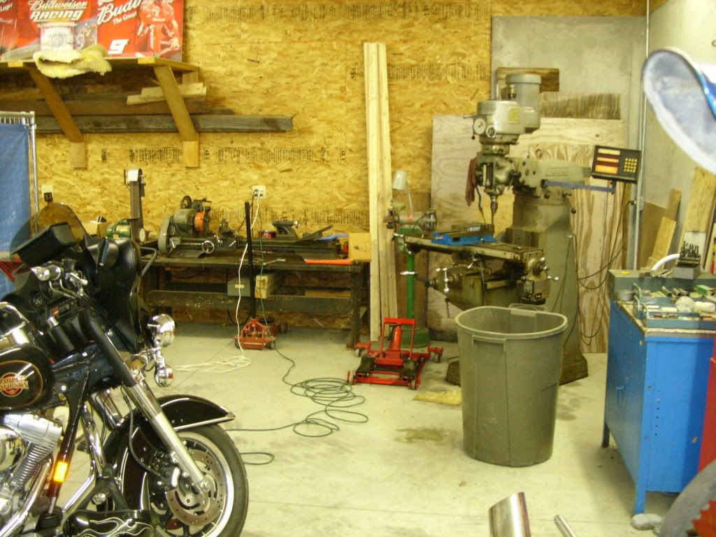

If you're going to buy one make the investment and get a bridgeport. If you decide later you don't want it you can seel it and get your money back..........they hold their value if you take of it. I have a bridgeport w/ a 9 x 42 table and digital read out (DRO) I bought a phase converter from MSC for about $150.

I second the rotary phase convertor. Get a bridgeport port with DRO. Used you can find them for under 3,000. You will not know how you lived without it once your done. For a lathe, i would look at the Enco with DRO. Hard to find a good lathe with DRO used for less than what Enco sells them for. Could run both off the same rotary phase convertor.
