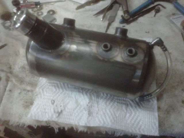

got my oil tank a couple of days ago from chassis designs. Looks like quality stuff

steve. which one is the vent line? Are the top ones supply and return and bottom a drain?

just 1 on bottom? i'd say the top 2 are vent and return the bottom is feed. that tank maybe setup to have to remove the feed line to drain the tank. wouldnt be the first time i've seen a setup like that.
Chopper J,,,that's what I was thinking also

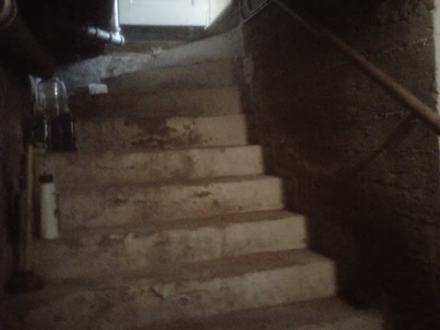

Rolled the donor bike out into the driveway, lyed it on it side and forund I still had a couple of hoses connected that I though i took off...much easier
here is its in the basement
and here's the freaking stairs I had to carry it down...what a pain in the ass

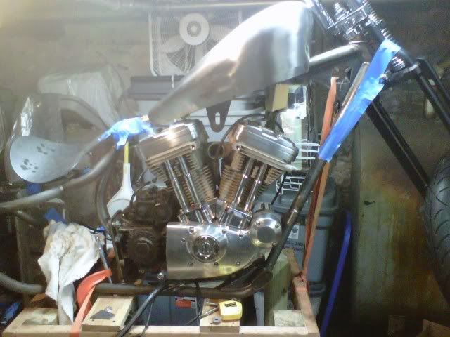

got the engine in the frame
