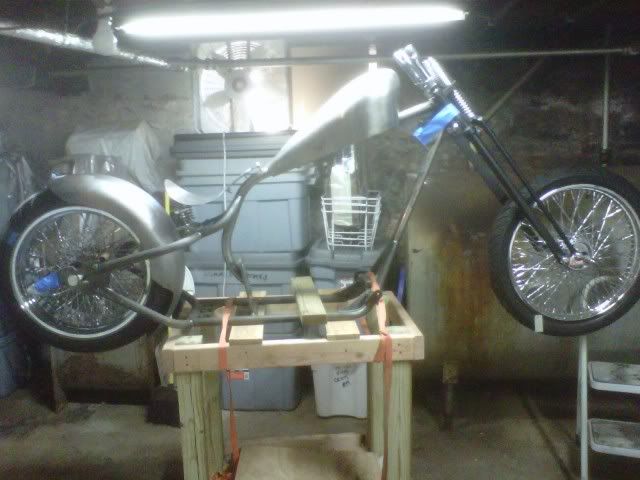

another pic

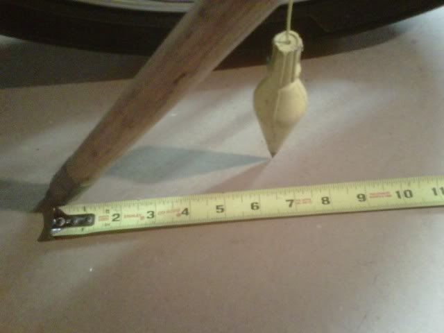

Im gonna have to make some longer rockers. Trail is too high. Looking to have trail about 4.5

I think your trail will change slightly when you put your motor in the frame.
...and my fat ass on it.
Good point

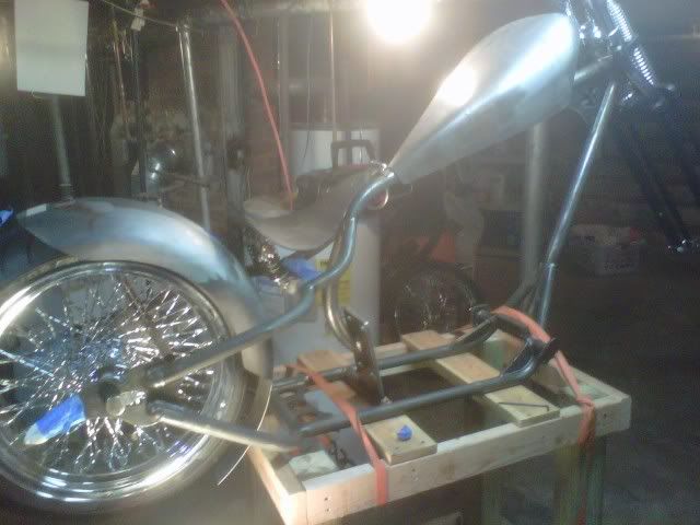

Heres another pic

I like the curve you put in your seat. I looks good and should hold your ass when you turn the go stick.

Thanks..I wanted it to follow the contour of the frame

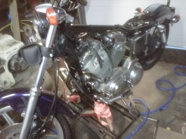

starting tearing down the sporty today

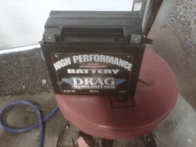

I got this added bonus with the donor sporty. A new battery installed in May

spart. great few pages you got going on.. that sporty is a deal and a half ,good find...
you nailed with the shape of the seat it flows with the frame... as far as the trial get the engine and tranny in the frame before cutting out rockers. make temporary rockers from plywood ,is easier and quicker in case you need to try a few different lengths. when you find the proper length cut some from stainless. it polishes up like chrome... do worry about that tank thats why there bondo....
