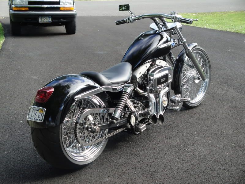

That is one of the nicest wide tire mods I have seen in a while!

that's some great fab work on the rear section, simple and gets the job cleanly, the bike looks great.
Did you use raked cups on the front end? what brand?

Very nice shovelhead. Well done !
I like the orange and white stripes on the black satin. I'm a big fan of black, and all black is nice but a little color or contrast is good for any bike.

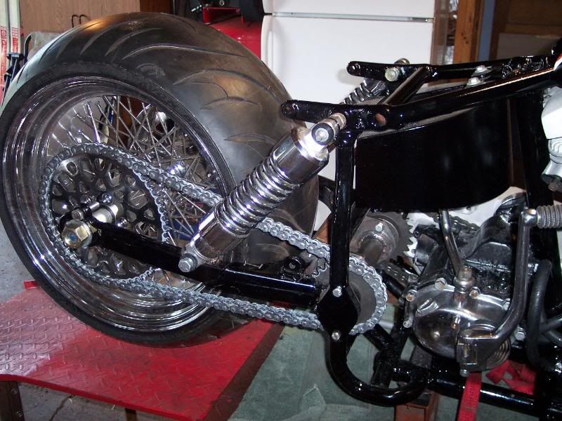

anychance you can show us some pic of the swingarm/ jackshaft modification? if you have it.
just want to figure out which part rotate and which part is fix. what puzzle me is how the swingarm bolt is secured to the frame while the jackshaft is turning. is it a double shaft?
thx in advance and let me know. would be interesting to seel the completed swingarm ( out of the bike)
i understand the concept and it so simple it stupid not to do one. will do this same thing on my next build! you convince me!

I don't know how often Sulley makes it over here to CC. Here's an album from the build.

Thanks Dave, i should hang out here more, the swing arm is only mounted on the out side of the arm, the jackshaft runs from the inside to inside of the arm, you can see it better in this picture, everything is mounted to the swingarm, all the bearing mounts and bearings, i had to make mounts to fastin the swingarm to the frame, i also made the mounts on the frame, the mounts i made for the swingarm seat into the bearing race of the swingarm, its a newer sportster swingarm and it uses cone bearings, take the bearing out and insert my mount, this thing was a lot of work and i wouldn't try it unless you have a lot of fabricating skills and are willing to cut up a Shovel frame. Sulley
