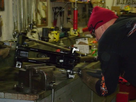

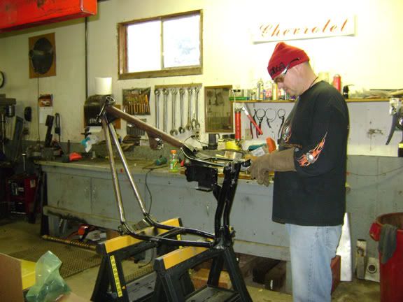

One of the things I hate about Dyna frames is the stamped piece of metal that they put under the seats.
Getting rid of the stamped piece of crap...
Further cutting down the rear fender struts which are no longer needed and would be in the way of fitting a 180 rear tire.

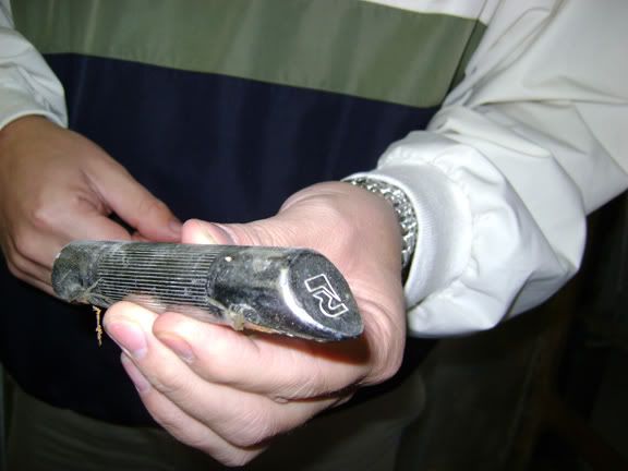

Remains of the Red Line BMX frame that my fabricator stole the metal from in order to build some new support bars in place of the stamped piece of crap.

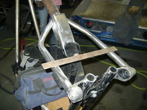

Red Line BMX frame tubing tacked into place....Maybe now I can go over bigger jumps.....
In order to do this tubing exercise correctly my fabricator had to lower the battey box and electrical box by 3/4" each...
I should have the frame up on my shop lift tonight...and I'm going to start putting this thing back together.

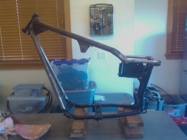

Frame is finished...
Starting assembly tonight..
