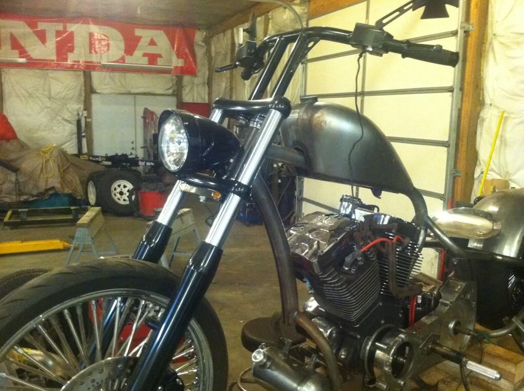

And finally, as I stepped back at the end of the night, this was how the whole package was coming together. I like everything so far except the bars. I'm not totally sold on them yet, but we will see how they look with the headlight and everything else on the front end.

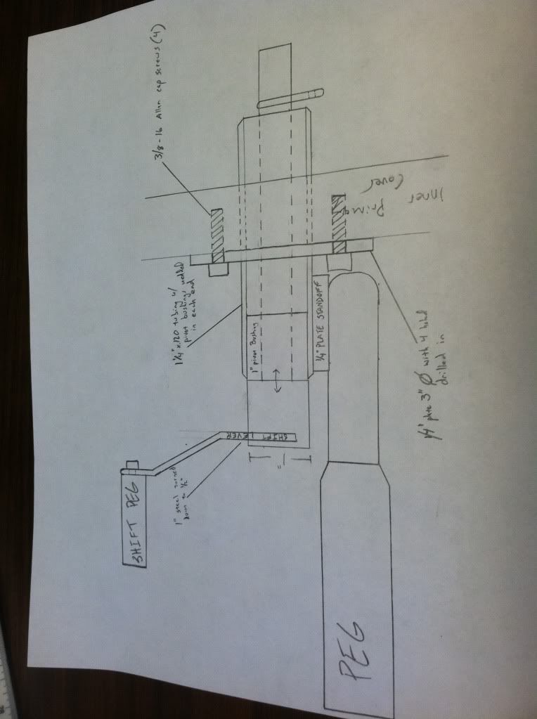

work is going a little slow today, so I decided to draw up how I am going to do my belt side mid control. Don't know if you will be able to make sense of it all, but I got it figured out. Now just need to find someone with a lathe to turn down some 1" stainless bar I have to 1/2" with a 1" end piece. Some bungking pivot bushing will be used to make sure that it all turns free. Hope it works!!!

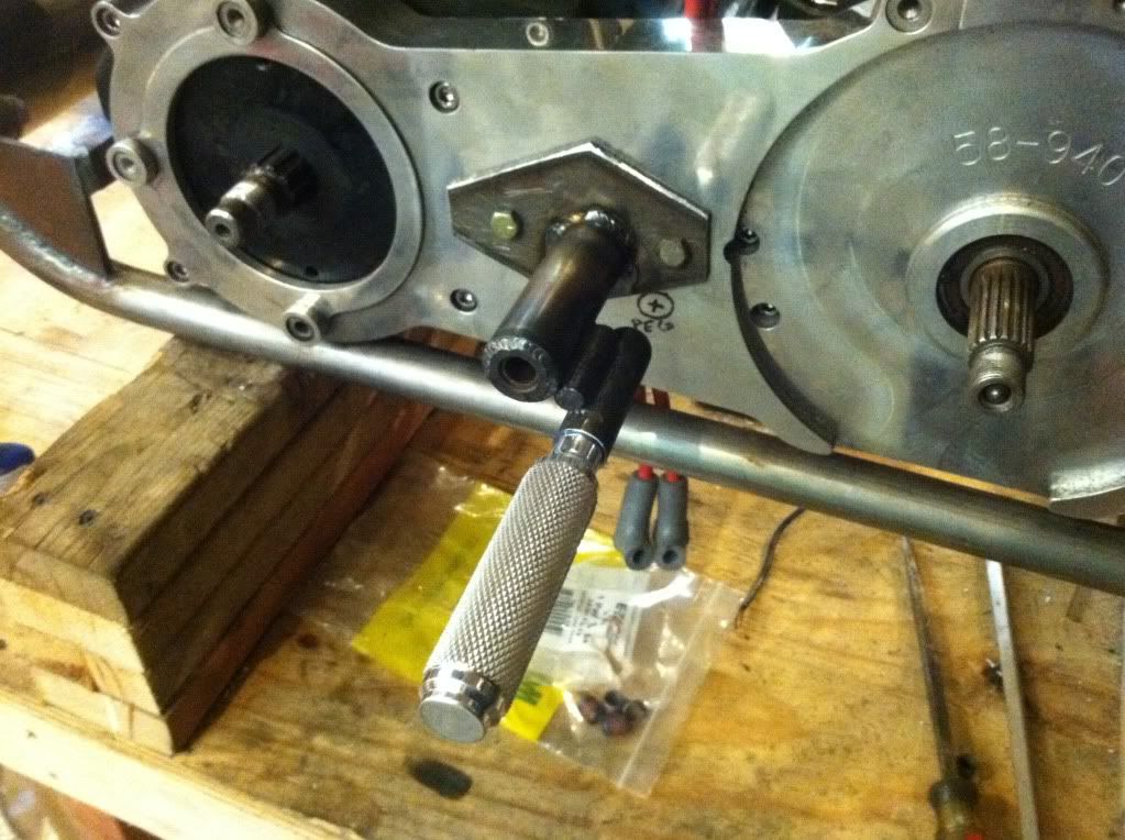

And Finally, I got the brake pedal made and mounted where it needs to be, and just need to finish it off by mounting my master cylinder. On the other side I got the sleeved bushings welded inside 1.25 tube and just need to finish the shift lever once I get the belt pulleys on for mock up.

About mid-way through the build of the shift lever mid control.

got the headlight and the hand controls and grips put on the front end. Doesn't look too bad now. Also, you can see that I need a 1.25" offset for the primary. My last build was a 300 so none were needed, but things get a little more interesting when you need offsets and whatnot.
