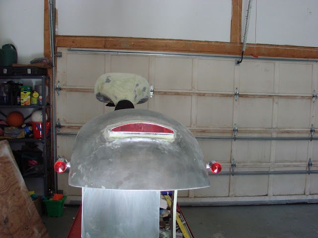

This is what the finished seat looked like
Didn't like it at all. Ripped it apart, remolded the nose to be flat against the tank instead if the point. Used neoprene rubber which was shaped with an angle grinder and 50 grit disk followed by hand sanding with 120 grit.
http://1.bp.blogspot.com/-rFxQvFsq-t...640/seat10.jpg
Also worked on the pillion pad. Not sure about how effective the suction cup approach is to holding the seat on but seems to be pretty common.
This is what the seats look like in raw neoprene.
Still not 100% happy but it will have to do for now.
Been going back and forth about turn signals. Not required in North Carolina but decided to add them anyway. The tail light is from a license plate holder that I disassembled and then made a sheet metal protrusion to mount it on the rear fender. I actually made the tail light mount last year.... I'm way behind on this log....
