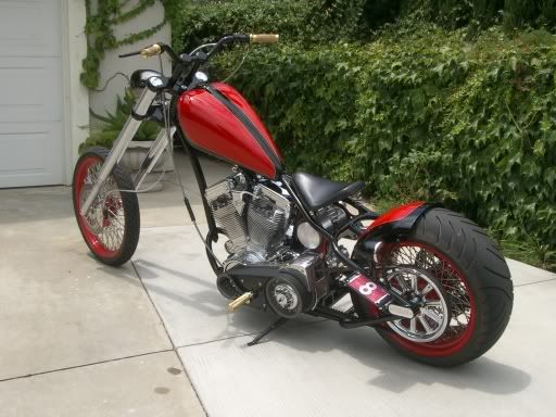

I just rode mine from So. Cal. to Sturgis. This was is first rigid. The ride is actually better then my last softail. The springs on the seat really take up a lot of shock and the larger tire helps also. If you can afford it I highly recomend Steve Damraiders mid controls. When you see that concrete bridge coming up its nice to know you can stand up like a dirt bike and let your legs absorb some shock if need be.

I ride mine all the time with a freind who told me when I first started riding it I leaned to one side. He told me recently I don't lean at all anymore. I guess I just got used to it. He also told me it looks really freaky leaning all the way over on a on ramp or turning. To me it feels perfectly balanced although it probably isn't.
