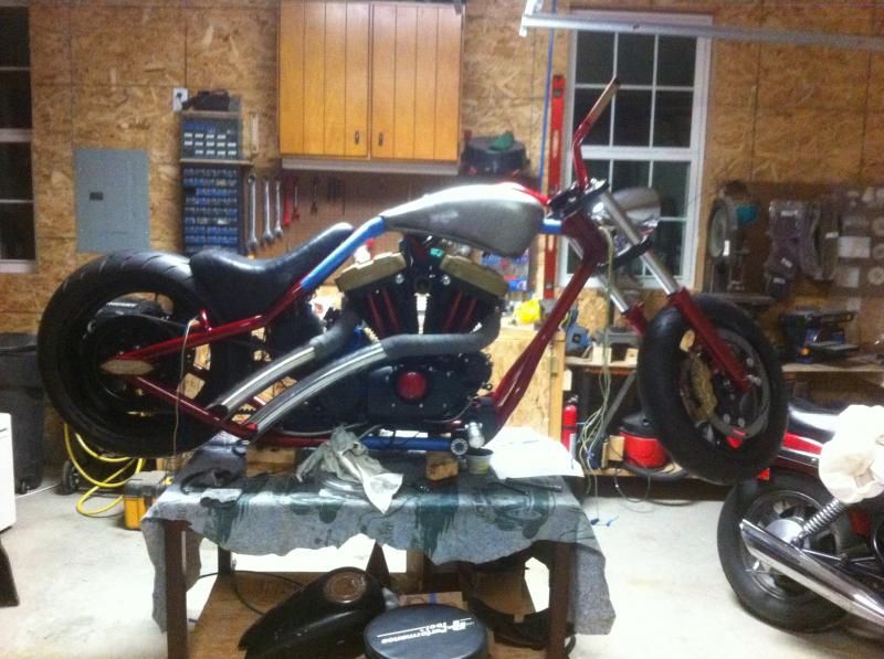

garage needed a good cleaning so i took her off the table and showed the sun again for the first time in 5 years! and i think she looks good.
just missing tank, seat, exhaust. (ok, wiring isn't 100% yet, waiting on a replacement rear turn signal should be here tonight)
