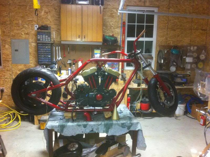

Hi All,
it's been years since i've posted but believe it or not i am actually still working on this project. Life has gotten in the way the past couple of years for me with many changes and major projects. But i think i can devote some more of the much needed time to this bike again.
I apologize to those who asked questions that i never answered, i will try to answer them now (though it is probably useless 2 years later):
Originally Posted by Onthisone View Post
Hey did you powder coat your screws or did you buy them like that I'd like some black and gold ones any help on where I can find them or make them?
I did PC the gold bolts and some of the black. I would not recommend that because as soon as i tighten them up with a hex key the coating gets damaged. the screws are made to fit a hex key tightly and there isn't enough slop in that fit to allow for the PC (especially a coat of gold and clear over that). I have since stripped and polished these bolts instead.
i would recommend finding black zinc plated screws in the size you need for black, and i have no ideas for gold.
Onthisone Looking real nice I'd like to do this to my engine, if ou could inbox me some tricks of the trade that would be great! I'm new to this so be easy. I have the engine out the bike right now but I'm scared to Clean it I stated using engine degreaser and stop because a new friend said that stuff will eat at your seals so he said use simple green so I'm trying that. Any help for clean up would be great thanks in advance.
yes i use simple green as a de-greaser before PCing my parts. but i didn't do the engine cylinders or case. they were already painted in black high temp before i bought the bike so i left them to save the trouble of disassembling the entire motor. if you want to PC the engine you're going to have to disassemble all the seals anyway.
Ok, lastly here's some progress:
1. Did most of my front end including fork sliders, triples and handlebars.
2. Because i can't coat the fork tubes and so cannot eliminate all chrome/silver finish from the bike i have abandoned that mission and have polished most bolts. i still plan on not having a lot of chrome, just nuts and bolts, but cannot decide on the headlight now. this decision on the chrome has made my life much easier.
3. PC'd my calipers in the metallic gold. with the rocker boxes, these may be the only big gold pieces on the bike. we'll see.
4. Did my front rim in satin black. took me forever as i used a powder primer that is supposed to be easy sanding to fill in the tiny surface holes from the cast rim. it was not easy sanding and took ~ 16 hours of hand sanding. i will not be priming my rear rim.
let me know what you think.

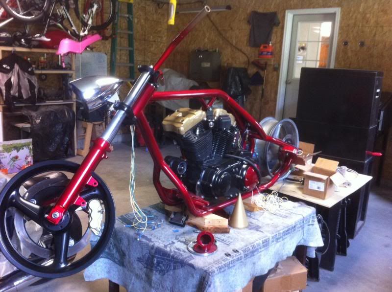

it's a roller
got the rear rim, pulley, and caliper mounts all coated satin black. mounted the tires and got the wheels on the bike.
still need to make a spacer for the rear caliper to fit between the frame mount and the caliper mount. anyone else ever have any issues on a mutant rear caliper not lining up?
when i bought the bike it just had a bunch of washers stacked on the screw. it looks like they are off about a half inch.

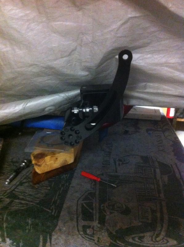

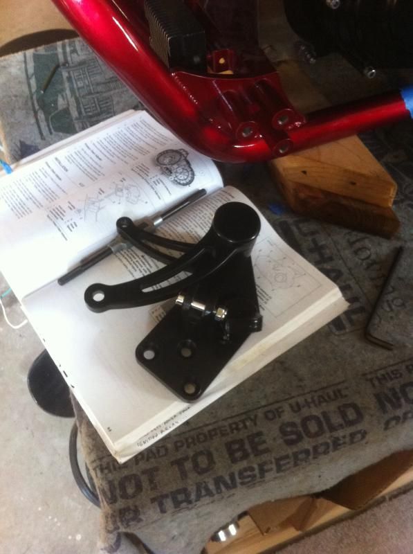

also re-made my brake lever arm. i dragged it before the tear down and it was pretty worn so i made a new one with my manual mill, band saw, jig saw, belt sander, and a lot of good ol' fashioned elbow grease.
step 1, band saw:
step 2, sanding and drill:
step 3, drill and jig saw the middle cutout:
step 4, mill the mount holes, tap center hole:
step 5, powdercoat:
step 6, mount:
