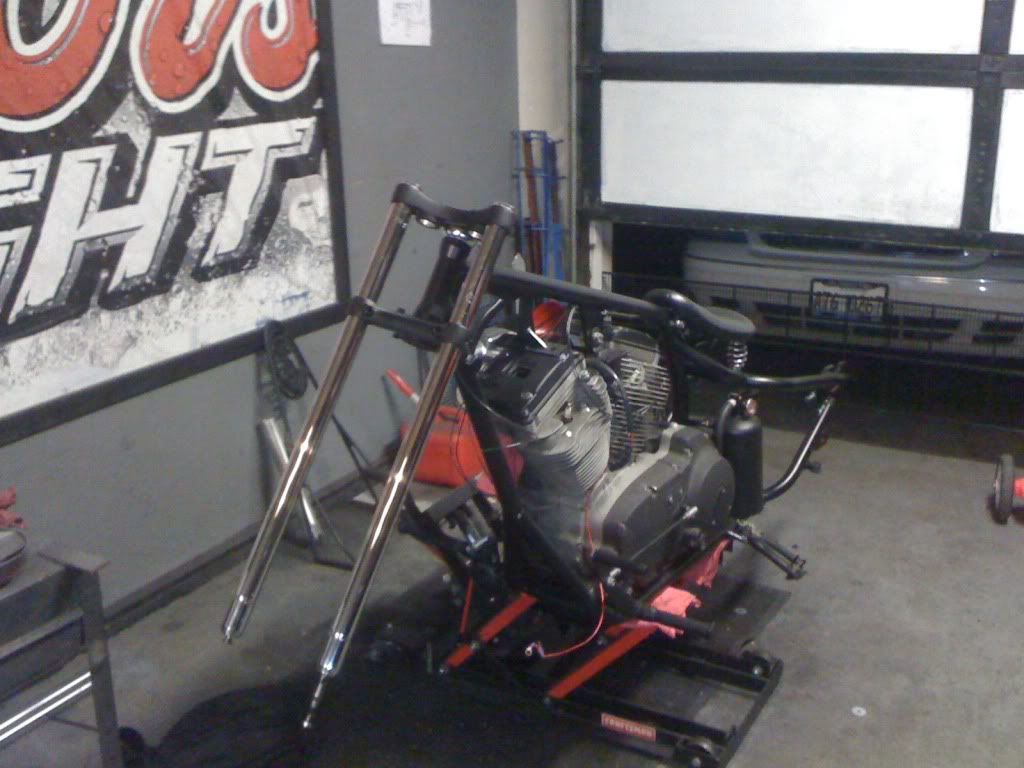

Paintin
Some During paint pics .
Frame painted
Engine back in, heavy as hell
Tank bondo'd and primed
Headlight bracket, spatter all over, gonna get powder coated
just another

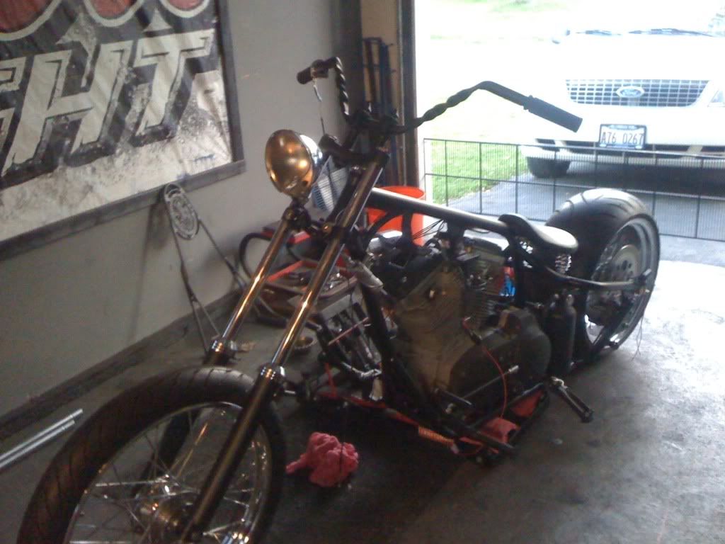

Got my VIN in the mail yesterday! they said it would be at least 30 days, but could be as long as 90, and got it in 12. awesome. so now its a big rush to the bike done. Got new tubes in the mail yesterday also, powder coated the trees, and got the tubes in last night and also got the seat mounted. hoping 2 weeks to have it on the road.
Pic from last night.

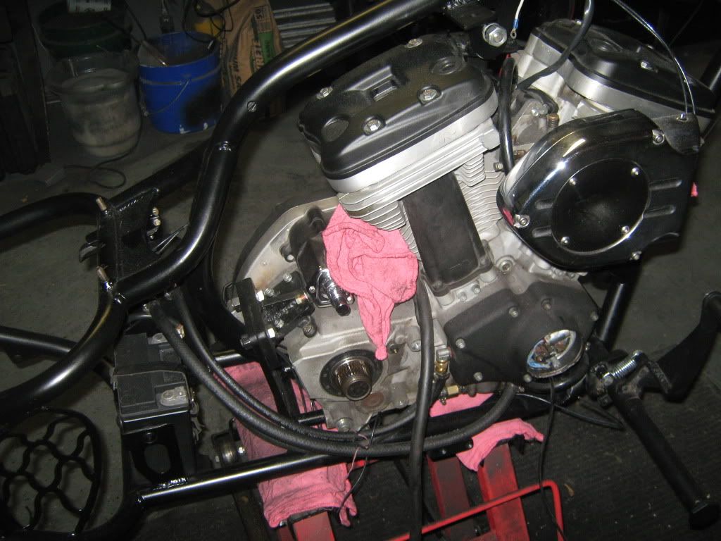

Got the lower legs, bars, and headlight bracket powder coated and on yesterday!

did it wrong. here it is full size
