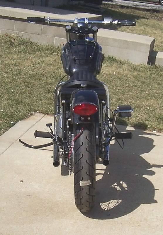

Gettin damn close
All that is needed is :
Gaslines
Front brake line
Wiring
battery box
boyer ignition
license plate bracket
liquids
3 switches
and of course tiddy up cables and such
added exhaust fins and rear brake rod after these pics
I like how the carb choke mount worked out simple but looks like it was meant to be there

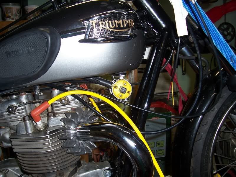

battery/electrics box is in needs polished next and on to wiring.
pic of the coil mount I took tonight

I like it!!!! lookin' Sweeeeeet! Did you make the electrics box, or is it modded from some other application?

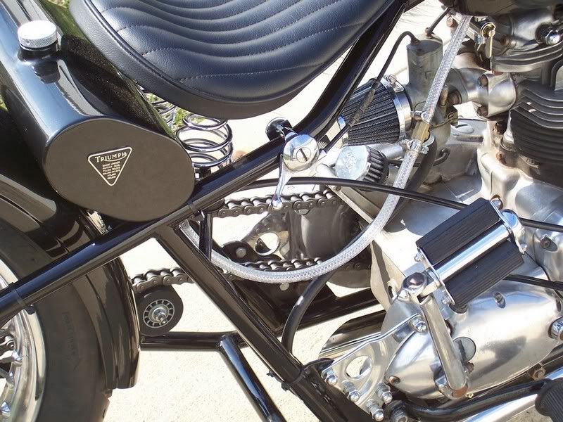

Nice work primate. I noticed in the pic' you had straight cut pipes and then slashed. Are those slashed pipes "TT's"" that exit under the frame? Where di you get them. I got a set Cycle Shacks but they don't look that nice.
That tensioner is a scateboard wheel. I have seen that done before!
Old 05-12-2007, 08:12 AM
Primate's Avatar
Join Date: Aug 2006
Location: circleville, oh
Posts: 322
yep those are cycleshack slash cut TT pipes ... Think it was Britcycle.com is where I got those .... I lucked out on them actually I called to order a regular set of TT and they guy went and checked ,said they had cycleshack slash cut some sets for them awhile back and that was the last set they had.
I dunno if that was just BS and they order them all the time , but I'd give 'em a call and see if they could get them if you want a set.They did'nt cost anymore than the regular ones though.
Nope my brother made the box for me at the metal shop he works at he is helping me get it done for Mid Ohio this year. Since I had the wreck and pretty much am a gimp for the next month or so. He has a snap on bike lift and all the tools you could ever want so we can get it done alot easier in there.I showed him my idea for the stuff and he made it out of SS dunno if I want to polish/leave alone/paint the box though.
