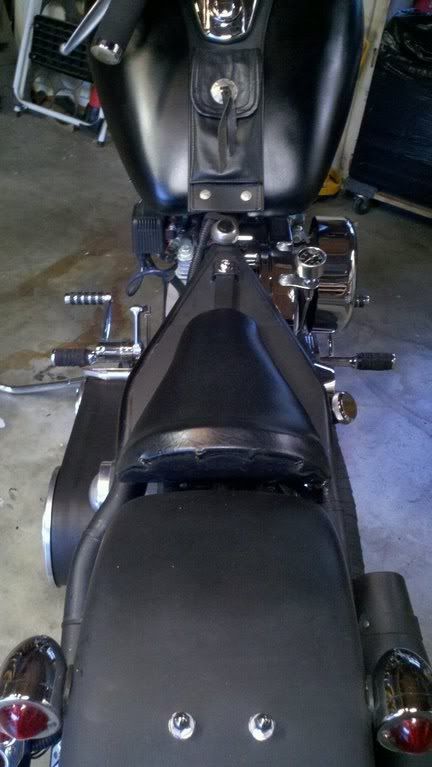

Here's how my seat, built in the fashion described above, looks on my bike. The first photo shows the U-bolt, crossbar, and spring deal.

So, is this a low-budget concept for a solo bobbed seat?
Without reading the entire post.....and just looking at the pics.....does that front bracket (the flat long piece that hard bolts to the square bracket ) actually function as a hinge?
How is the comfort of that seat in the pics? Looks like all padding, little form. Maybe I should read the entire post...lol.

The steel strap is long enough to provide just enough flex so it works without an actual hinge. As long as the rear of the seat can move downward and compress the springs its all good. This particular seat is all foam and there's no padding. Is it a comfortable seat? No, not really, but all I was after was taking out the kidney/tailbone punishment you get on washboard roads and the occasional bad bumps in the road you sometimes fail to avoid. And this setup does that. I addressed in the up-board post, or tried to, how far you'd have to go to get anywhere close to semi-comfortable on a rigid. And this, for reasons I also wrote about, isn't that.
