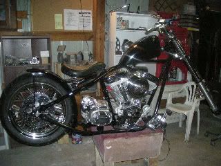

This is a piece of 2" x 1/4 strap steel from Lowes...heated and bent around a jig that was cut from a piece of 2x12. It would support Rosanne Barr... though the spikes would have to go...

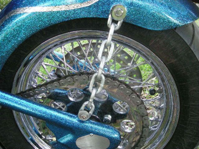

I have since painted my struts a chrome metalflake they look so much better.

Here are some small diameter struts on my daughters bike.
