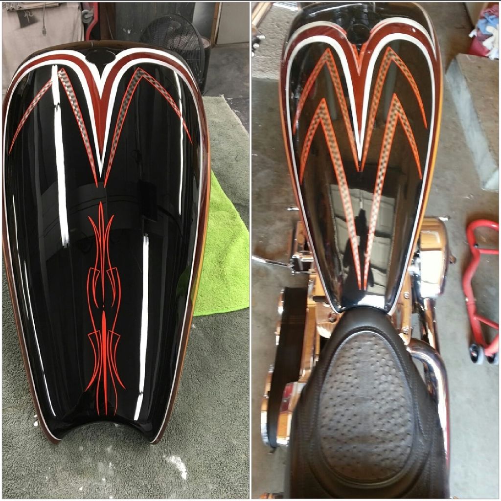

Old 07-28-2016, 08:07 PM
Tx51's Avatar
Location: Amarillo, Tx
Posts: 1,130
Originally Posted by magnum45pete View Post
all SO CALLED TANK SEALANTS ROT WITH MODERN FUELS AND YOU END UP WITH WORSE PROBLEMS THAN A LEAKY TANK... HAVE IT WELDED , TESTED (WITH kEROSEAN) AND RE-PAINT
A REAL GOOD PAINTER COULD REPAIR THE PAINT WITHOUT DOING THE WHOLE TANK BUT FINDING SOMEONE WILLING TO DO IT MAY BE A JOB, AS THEY LIKE TO EARN MORE MONEY ON A FULL RE-SPRAY THAN A SIMPLE REPAIR.....
Pete ....i found the guy who took the time to fix this without repainting the whole thing. Unlike most painters who were thirsty for cash....he charged me little to nothing since i always send him business...before n after below...he sealed the tank n fixed leak...couldnt match the striping paint so he did his own thing....like new!! Its nice to find someone who knows what they are doing and not trying to make an extra buck.
Chesty Puller

Old 07-29-2016, 10:29 AM
Captain America's Avatar
Location: Reading, PA
Posts: 3,860
That's a nice repair job, to my eyes I like the pinstripe on the repair better than the original work. It's great when you find someone who does nice work at a reasonable price, now that the chopper craze is over I would think the guys who charged thousands and thousands for basic paint work are struggling.
